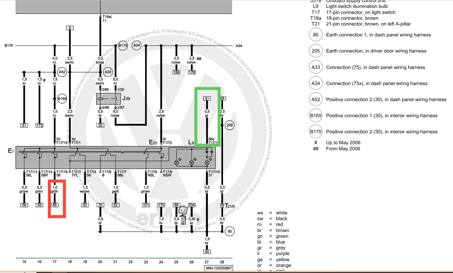

@nige8021 , and @rj_BNM , the wire colours at the light switch are confusing relative to the colour code that generally provides illumination feeds.
The grey/blue ( (in red box)) is the power from the light switch going to the dimmer switch, and rear plate lamps.
It's the grey wire at pin 17 (in green box) that is the controlled, dimmable feed from the dimmer switch to the illumination of the light switch, and therefore the one to t-off for your new gauge.

@Pete1 that is very strange it is only on the 9N1/3 that the output from the dimmer unit is grey on other models pre and after it’s grey/blue on other models in the VAG range also use grey/blue as the dimmable output I’ve got part of a loom for my 08 Audi A6 and the backlighting wire is grey/blue
Unfortunately the OP hasn’t specified what model they have
Could be an error in the wiring diagrams, I guess.
I no longer have a Polo to look at. ☹️
