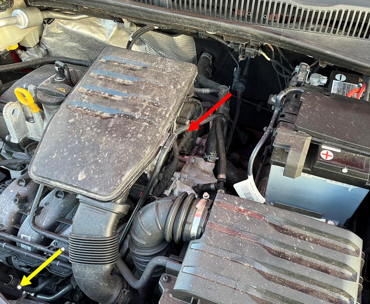

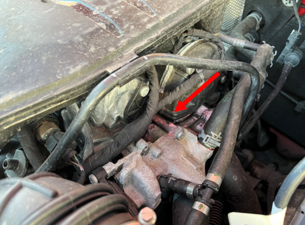

I can see a slight leak from the area shown in the photo (red arrow) .. im not sure what the circular black casing is , but looks to be coming from a joint there ? Any thoughts/advise welcome.
NB is the water pump the one at the bottom of the engine bay driven by the timing belt ? (Yellow arrow in 2nd picture)- I cant see any obvious leak there ?

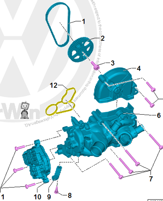

My understanding is the pump is not driven from the timing belt (on different sides of the engine), but has its own belt, as per diagrams below, so not sure why the timing belt needs changing ?
Timing belt on left of engine (UK drivers side)
Cooling Pump & Belt on right of engine
I'm far from an expert on the newer engines, but what you're saying looks and sounds more plausible than what they're saying. Can you see any signs of a leak with the engine running? Do you know the engine code (normally 3 or 4 letters and numbers, possibly on a label on the timing belt cover)?
