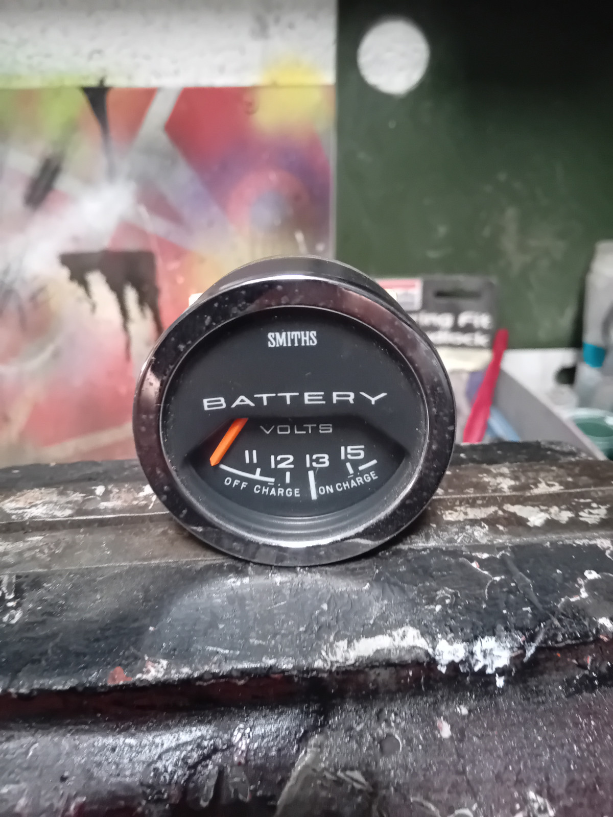

I have an old style working volt gauge i want to install im my gt breadvan. I Had a look on the tube but still confused 😕
Two terminals on rear , one i assume positive and other ground ? Not worried about light in the gauge as its missing.Does the ground wire go to neg on battery terminals?
So where do i connect positive ? And will i need inline fuse on positive side ? If so what amp ?

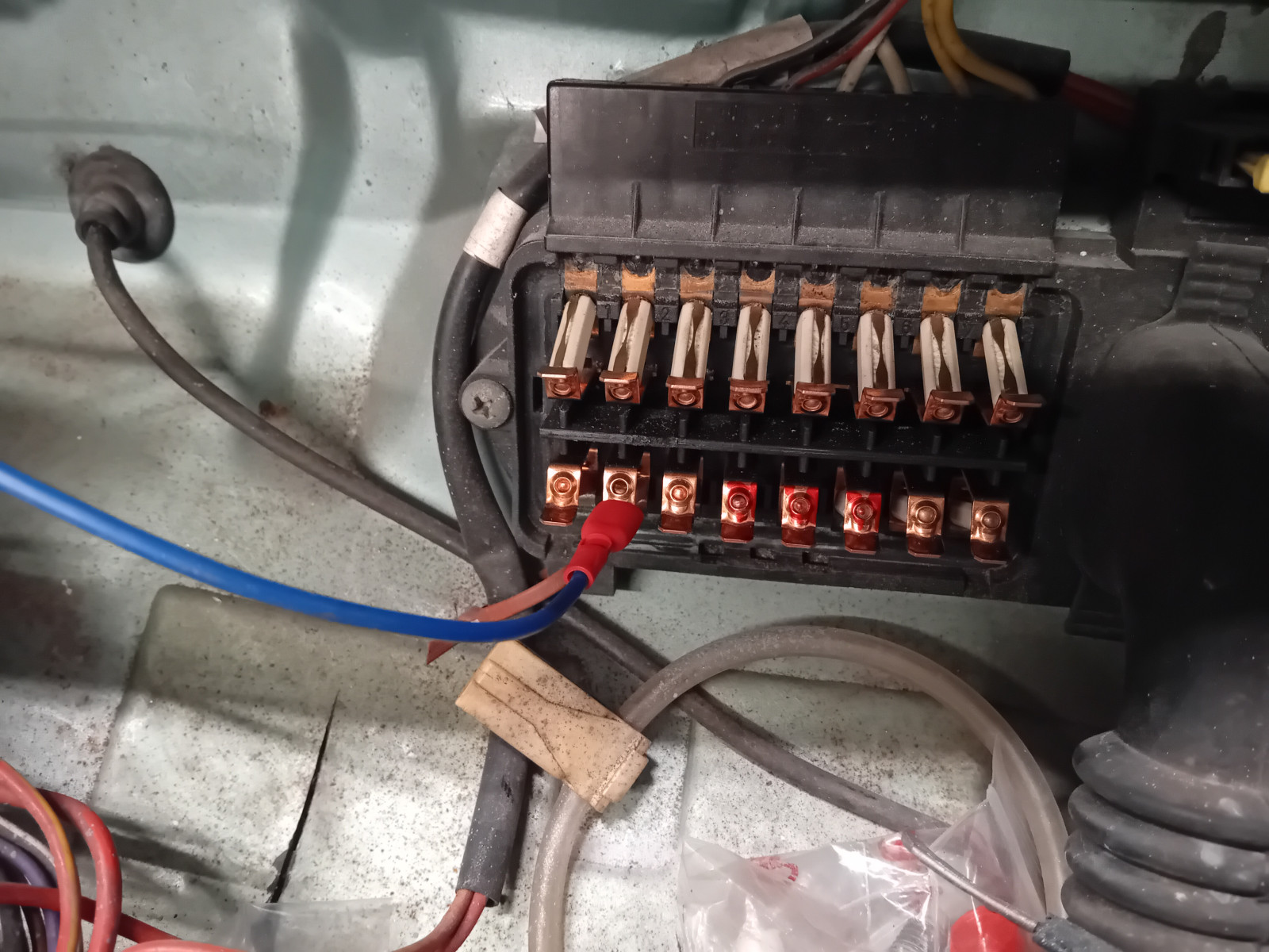

Update , I used this spade connection on the fuse box and it's only live once ignition is on. Second wire was ground on same point as dash ground.
It's not ideal place as I will most likely have to modify the fuse box cover .
It's working but again looking at helpful comments please. ?
Do i still need inline fuse ?
There will be an ignition on supply on the heater blower switch that might be easier to use rather than that lead from the fusebox and yes I would still protect it with an inline fuse

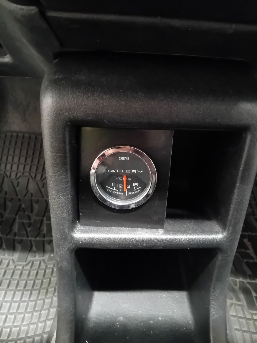

I left as is but with inline fuse now. I made my own holder bracket etc. Thanks all for help.
