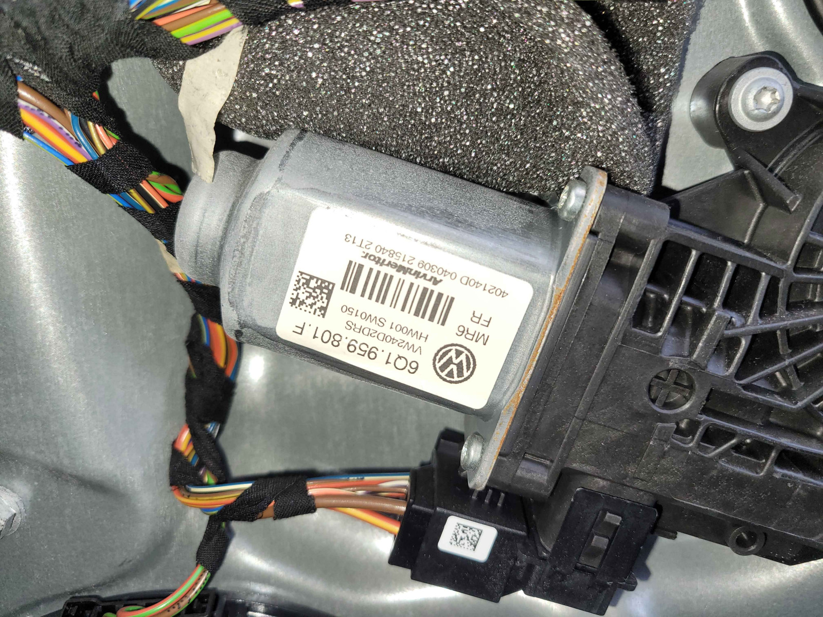

I took it to an auto electrician this week, who checked the wiring and a pillar connection in the drivers side door. They found some corrosion in the plug of the window regulator (6q1959801f) which they've cleaned but the issue hasn't gone away. They suggested that the next step would be replacing the unit but I'll have to source my own. (They gave me the part number for the Y variant, but having been inside my doors I know the car has the Q version fitted...)
I've seen suggestions that it could be the microswitches inside the lock module itself, but I'm unable to get this deep in to the car door myself. This also seems like it'll be quite expensive to get fixed, and i cant check part number from the outside.
Basically, does anyone have any ideas? Could the drivers window regulator really causes the car to unlock and lower both windows, or is that a red herring?
Yes, because the key position information from the lock module goes first to the window motor (to enable the 'lower or raise both windows via key in door lock' function).
From the window motor it then goes onward to the central convenience module above clutch pedal for locking system control.
If the moisture ingress has caused circuitboard damage in the window motor module, this input from the lock module may get corrupted and cause both locking and window activation without any real key input.
I think I have a suitable 6Q1959801F unit that could be tried if you fancy an eastward trip along the M4 sometime.

The auto-electricians I went to are adamant that the dealer specified that 6Y1959801 is the right part for my polo, but as shown in my original post, the part currently in my car is definitely 100% 6Q1959801f. Are these interchangeable? To my eye, they look like they'd mount differently, and the Y version definitely has a 2 connections whereas my current regulator has only 1 connection (and no sign of another unused wire hanging around).
Not readily interchangeable, if at all. As you rightly say, the connectors involved are completely different, so bodgery or loom replacement would need to be done to change from one type to the other.
I'll start a private message conversation with you so that you can share the vehicle VIN with me without publishing it. I can look up which part was factory fitted, but I think in 2009 it's highly likely that the one you see installed currently is original and correct.

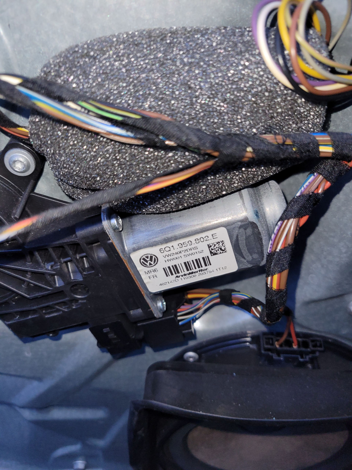

The passenger side is fitted with what I assume is a match to the same family as the drivers side: 6Q1.959.802.E.

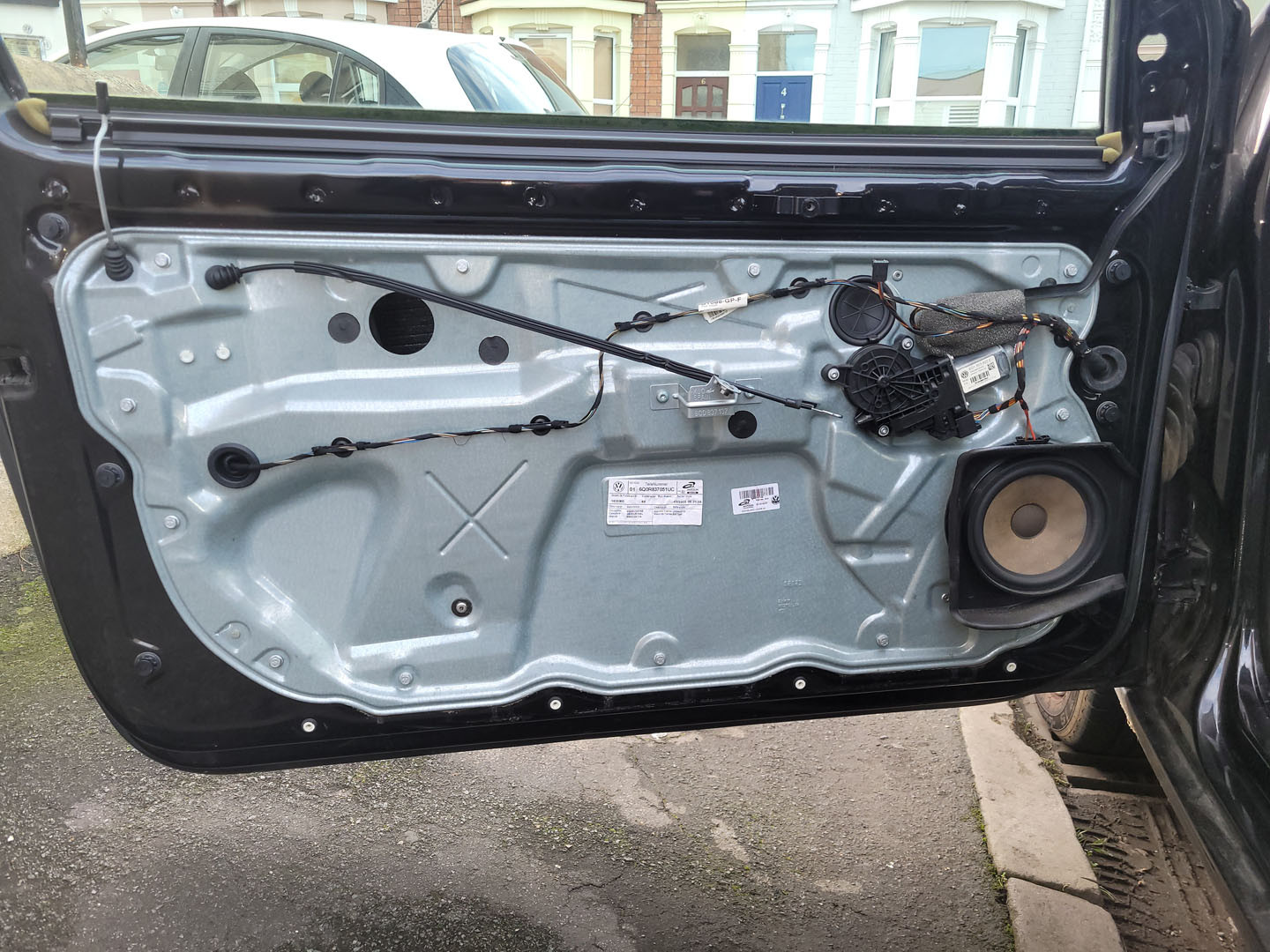

Added a photo of the passenger door opened up. Unfortunately, I didn't have the presence of mind to take a nice wide photo of the drivers side door to match.

I thought that's what would be on passenger door.
Date code consistent with vehicle manufacture date too.
Yes, I have a suitable 6Q1959801F here. Would be same price territory as ebay ones, but known good (repaired by me).
