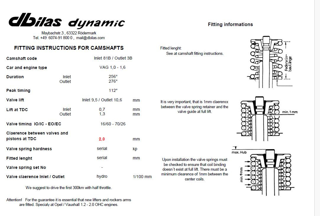

This is the cam data sheet, how can you access the spring assembly to verify the clearances? It's a standard head never reconditioned, just had the seats reground with paste.

As for valve springs...
I only know mechy heads, where you can slide a feeler gauge blade between the springs without a rocker arm, and then with one. If pistons are halfway down cylinder and no cambelt you can turn the camshaft as much as you like with lever in the cam pulley. (two M10 bolts in a flat bar)
