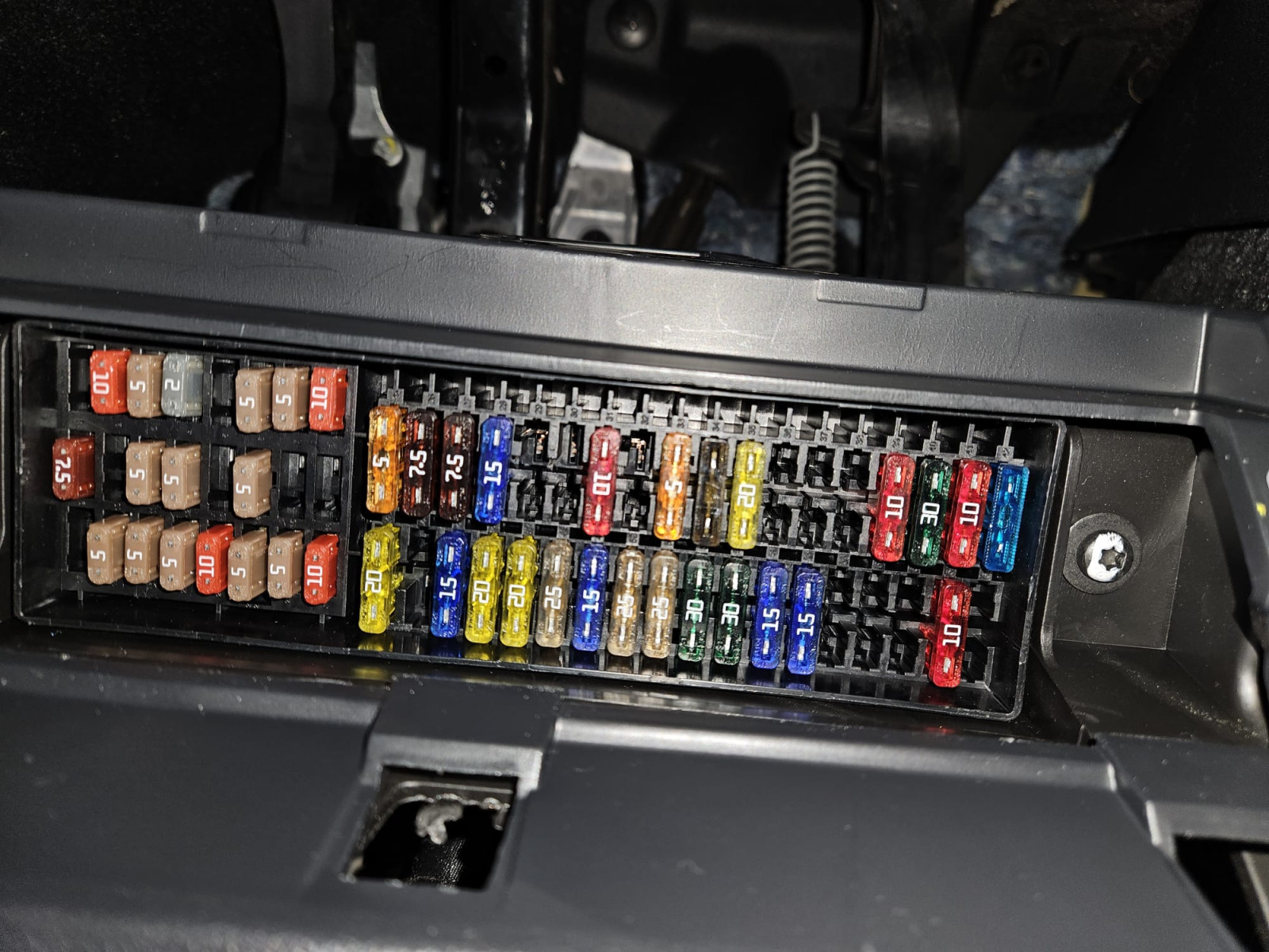

Hi, first time here after inheriting a 2011 Polo. Unfortunately, there's no heating in the cabin.
Trying to take a systematic approach to it; I've confirmed all fuses that are fitted are ok (incidentally main beam wasn't working; I found fuse 34 missing, replaced it and they're now working grimace ... I don't know how this thing got through MOT).
I'm working from https://polo.blue/fuses-and-relays-in-polo-6r/. I believe I'm looking for the low and high output heater relay fuse(s). That's fuse 20, and that's ok.

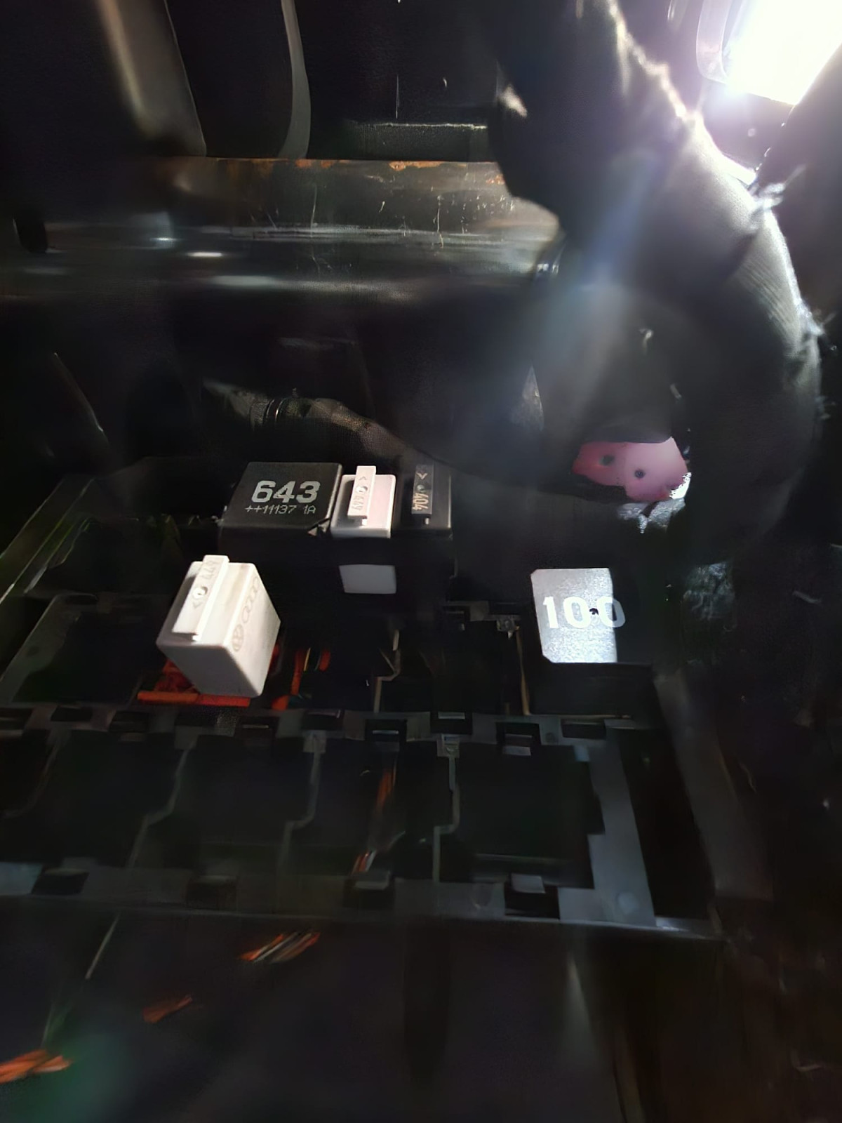

Going to the relay box though ... I don't seem to have relays (or anywhere to plug them in) in positions 1 and 2. Looks like I have 30V supply (643) at 3, dipped beam (449) and fuel supply (404) at 4, fuel pump (449) at 7 - and then what looks like the x-contact relief relay (100) at 10.
I tested the x-contact relay and that seems fine.
Before I start taking things apart am I barking up the wrong tree?
Thanks!

I expect only the diesel engined cars got the additional electric heater that those (absent) relays control.
