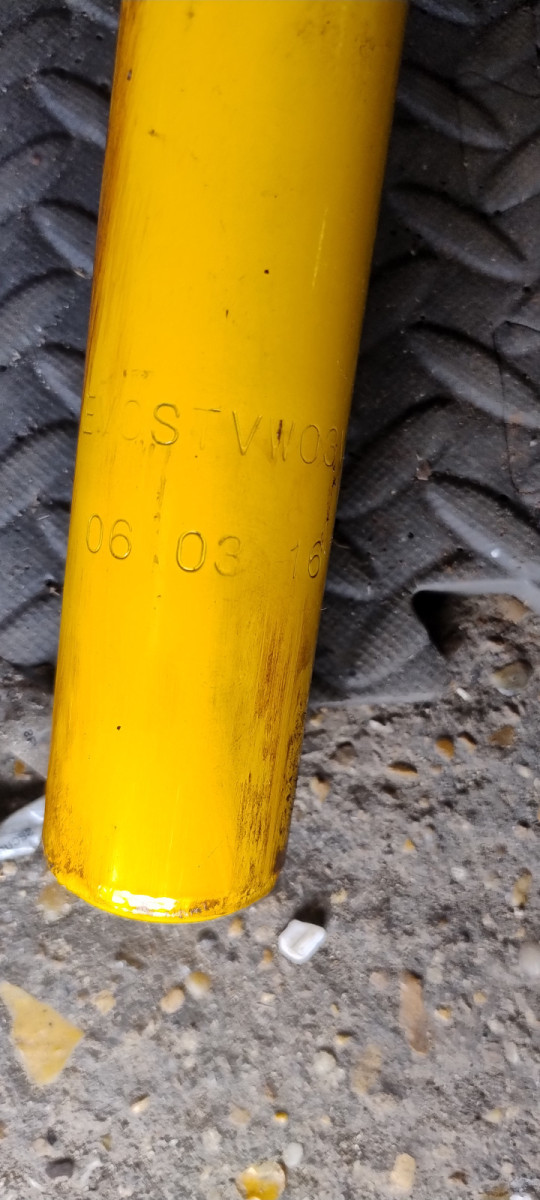

On 06/03/2026 at 21:40, dvderlm said:
I think mine is FK or KW. Yellow, cheap so not actual Koni. Lowering Bonrath camber adjust top caps and 5mm rear spacers for wider track spring clearance with the summer alloys. Can't believe has lasted this long (14 years?), but beginning to be bouncy on the dreadful roads.
Evo STVW03 dated 06.03.16.
So 10 years (driven for less than that).
Bought new TA-Technix cheap yellow lowered 60mm front shocks for now from Mecatechnic, and they are the same, just dated April 2026.
