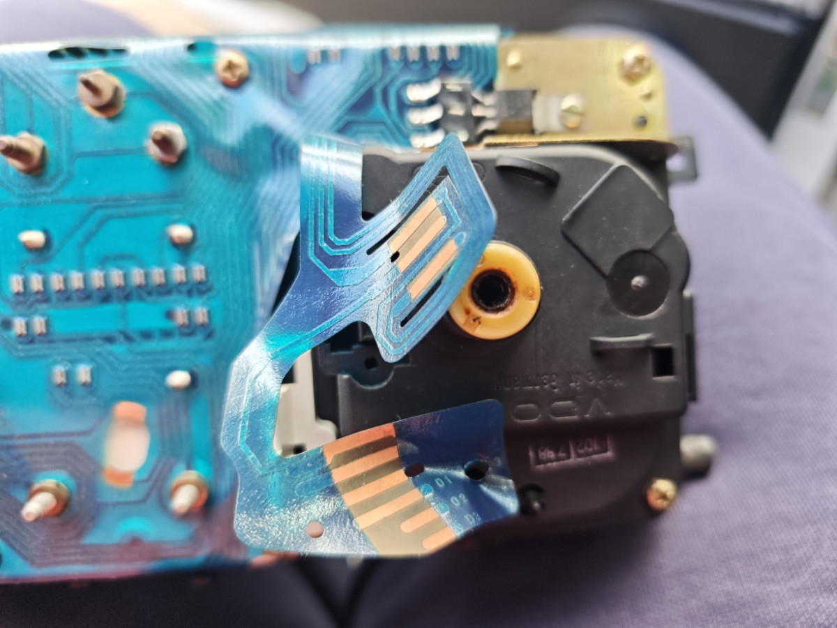

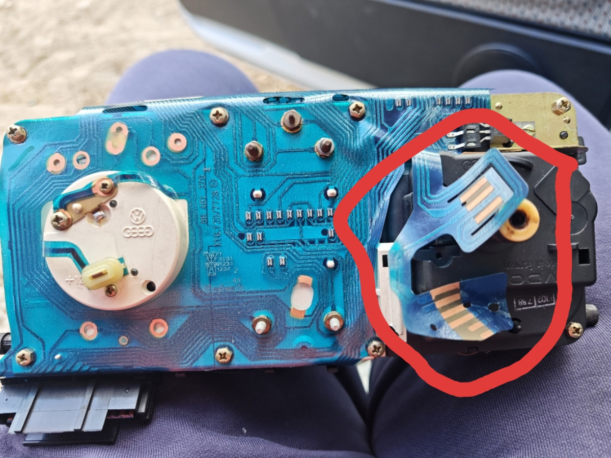

I am having some issues with the instrument panel, does those connectors losen go to somewhere??
Thanks!

    That is probably a plastic cog worn or stuck. Might need a specialist to repair it.

They look to be near the speedometer.
Oh, maybe for the Formel E early start stop system SSA?
Do you have a clock or a rev counter?
There is an oil pressure sensor buzzer (J114) that is only enabled when engine warm and revs over 2000rpm, as well as the usual low pressure sensor. Pretty sure that is a hard plug and socket inside the clocks case though.

Should I be opening the clock enclosure to find a place for the connector?
By the way, I was trying to fix the Tacho. I have speed but no km counter.. 😔
No nothing to connect to. It's a modular design by VDO.
Only the Formel E uses those connectors.
