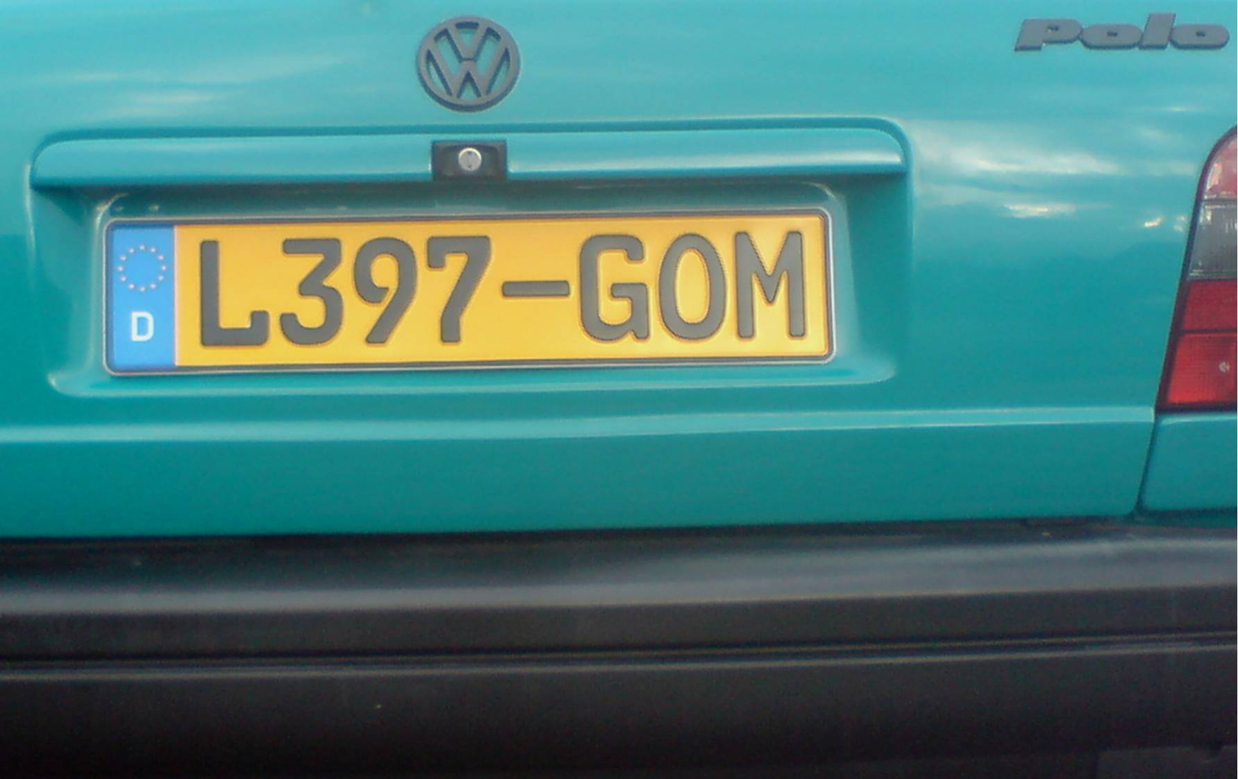

It starts - my boot plynth on the car:

The comparison -
The final finished item.
