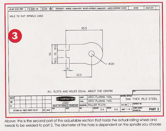

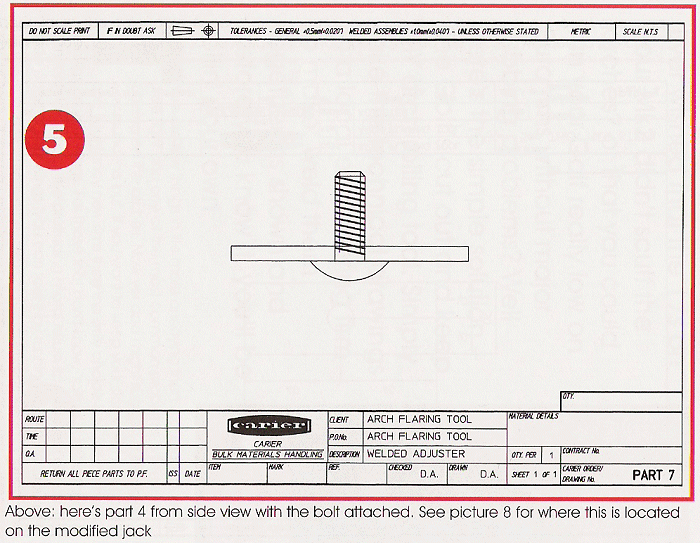

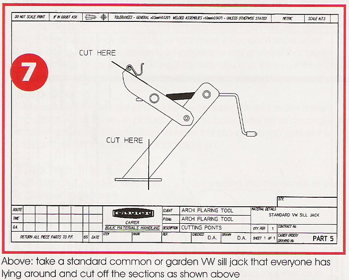

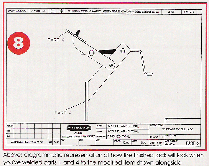

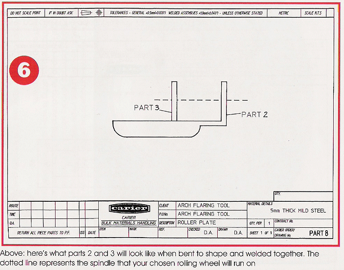

Make Your Own Arch Rolling Tool
randomly found this online.. may interest a few of you ?
