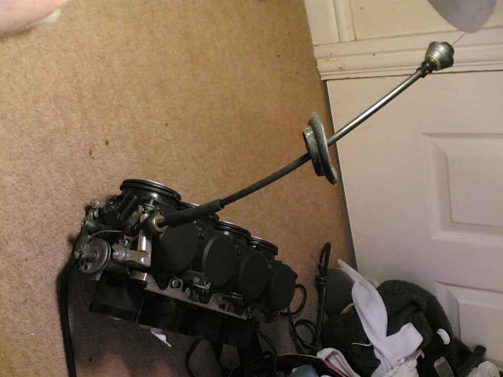

And my MK2 is on CBR bike carbs,which are also pretty similar.. I intend to do a full write-up,giving details of various applications,methods etc including my own. But until i can upload pics,its not worth doing. I've already sent Hypojam what he needs to know,but here is a little something to give you all the general idea..

They require light pressure fuel,so the fuel pump just goes back to the tank and a T piece on that line connects to the carbs. I've not connected the coolant pipes,as i dont see that id benefit from heating them,though i might set it up for a trial when i Roll-road it. A choke cable is £10 new from Mini Spares,and modifying the end of the throttle cable to fit the wheel just requires a hacksaw..

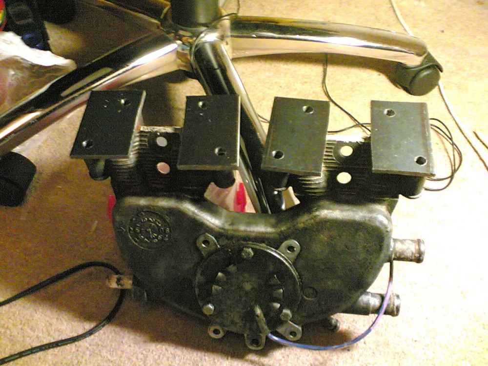

The main jets will have to be drilled with a precision bit,ranging from about 1.30 for a 1050cc to 1.70 for a 1600cc 16v (my 1.6 8v is on 1.50 as thats the only drill bit i had,but its fine). And manifold - It can be made in alloy by boggbros.co,in steel using a modified tubular exhaust manifold from a K-series,Volvo S40 etc or by using 40mm flanges/industrial silicone vacuum pipe,as i have.

Nice links - this is the one that stirred my interest last year.. http://www.boggbros.co.uk The bloke was helpful without wanting anything,almost trying to talk out of selling me a manifold when i described the independent flange set-up id made myself,using 1.25" rubber seals as gaskets. But he spent ages giving me the advice that proved to work.

So i can see that a rear brake bike cable will fit but how does that then connect to the throttle pedal?
I didnt use one. They appear to fit,but the bike fitting is actually a fraction too big. Its easier to cut the ball itself off the throttle cable - keeping the pressed stub part still on. Best way is to cut with effort and the wire cutter in pliers,then use a fine file to trim it for the slot in the wheel. That wheel's a tad small for heavy traffic,can switch to a larger one later tho.

As for my manifolds,I've used simple flanges,bolted to the head using like an O ring to seal them. Then some wire reinforced 40mm silicone hose linking the carbs to them. The carbs are held rigid by a bracket each end. I had no guide for this,i just visioned what i needed and went out and found things that i thought would fit. These parts would be found from an industrial machine parts supplier.
