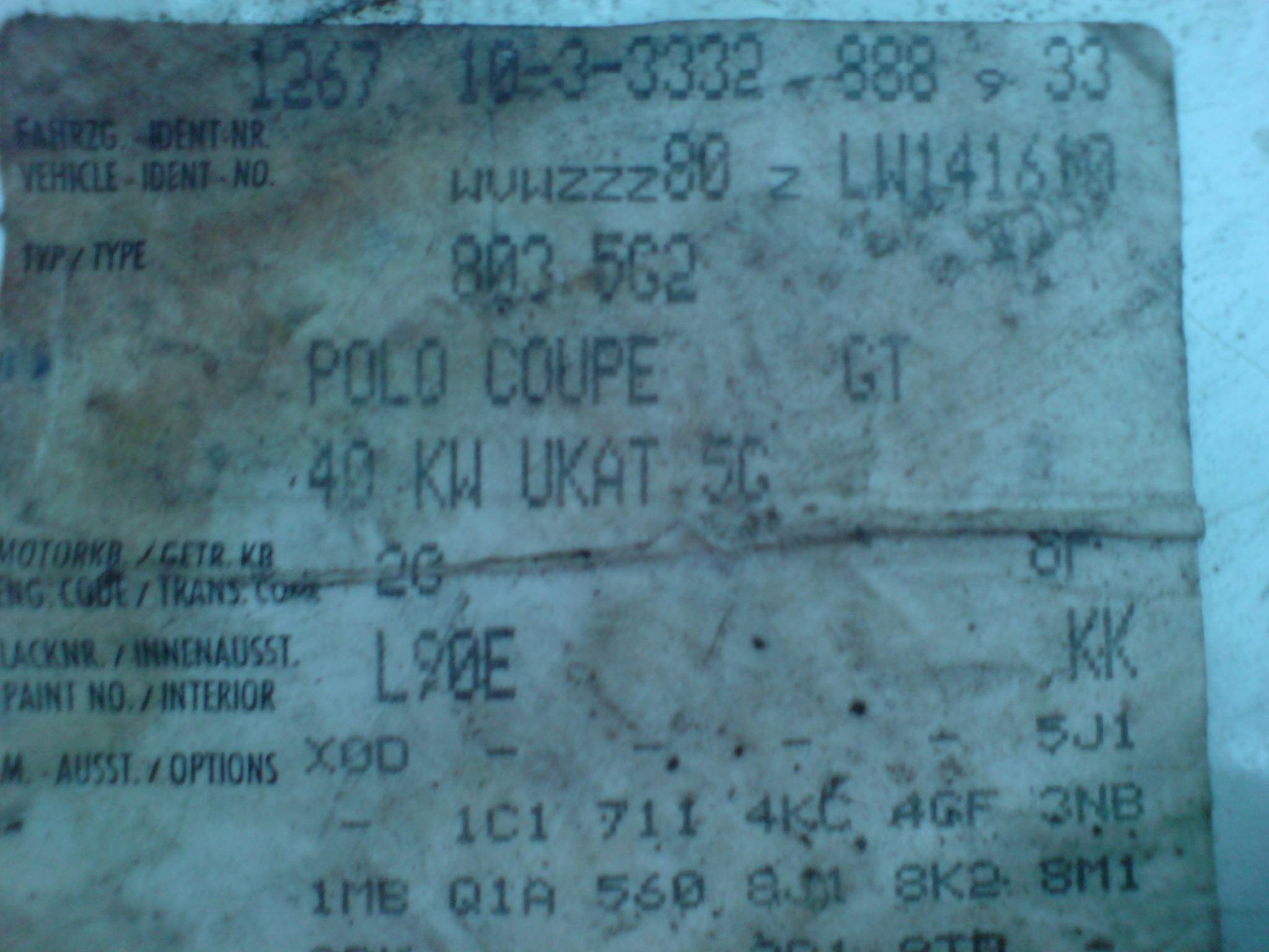

I have had a look in my boot at the sticker and the engine code is 2G if this means anything.
its got the P8 box and stuff.
Just what does this 2G mean though?.
Ball :thumbsup:
2G is just the standard 55 bhp carbed 1.3 in the Mk2 I think.
Look at the sticker on the inside of the rear panel,under the load sill. Right under there,where the carpet meets the panel. It should say something like:
POLO COUPE GT
40 KW . . . 4+E
MH . . . 8P
Mine is obviously the MH engine,and there will be chassis numbers above,and specification details below. But is there any other differences in that information I've shown?
Here we go.
What you can tell from this i dont know but hey.
Ball :thumbsup:
Edited by Ball2
Yep - 40kw GT. Its an S I'm afraid,but got through without having the GT badge changed to S,probably at the request of the first keeper. Same as all rhd,then. MH/2G no notable difference - though yours is probably spanish. It'll tell you the place of manufacture on the slam panel plate. Mine is West Germany - made before the wall was pulled down.. The S was a detuned GT,it only had the standard compression (9.5:1) and tune,ran 55bhp @ 5200rpm and 96NM of torque at 3400rpm. Performance? 0-62 in a leisurely 14.8 seconds,according to VW. The 55kw GT,which was lhd only,reached 62 in 12.1 for the four speed,and 11.9 for the five. Sorry.. VW wouldnt fit the 55kw engine to the rhd cars,as they hadnt developed servo assisted brakes for the car. With the likes of the Nova GTE and Fiesta XR2 hitting 60 in less than 10 seconds,VW had to adjust product placement,and the Polo GT found itself along side the still-quicker Fiesta 1.4S and Nova 1.3SR. Sticking a tacky S badge on the Polo allowed the car to be registered as an S - the idea being to please insurers iirc.
