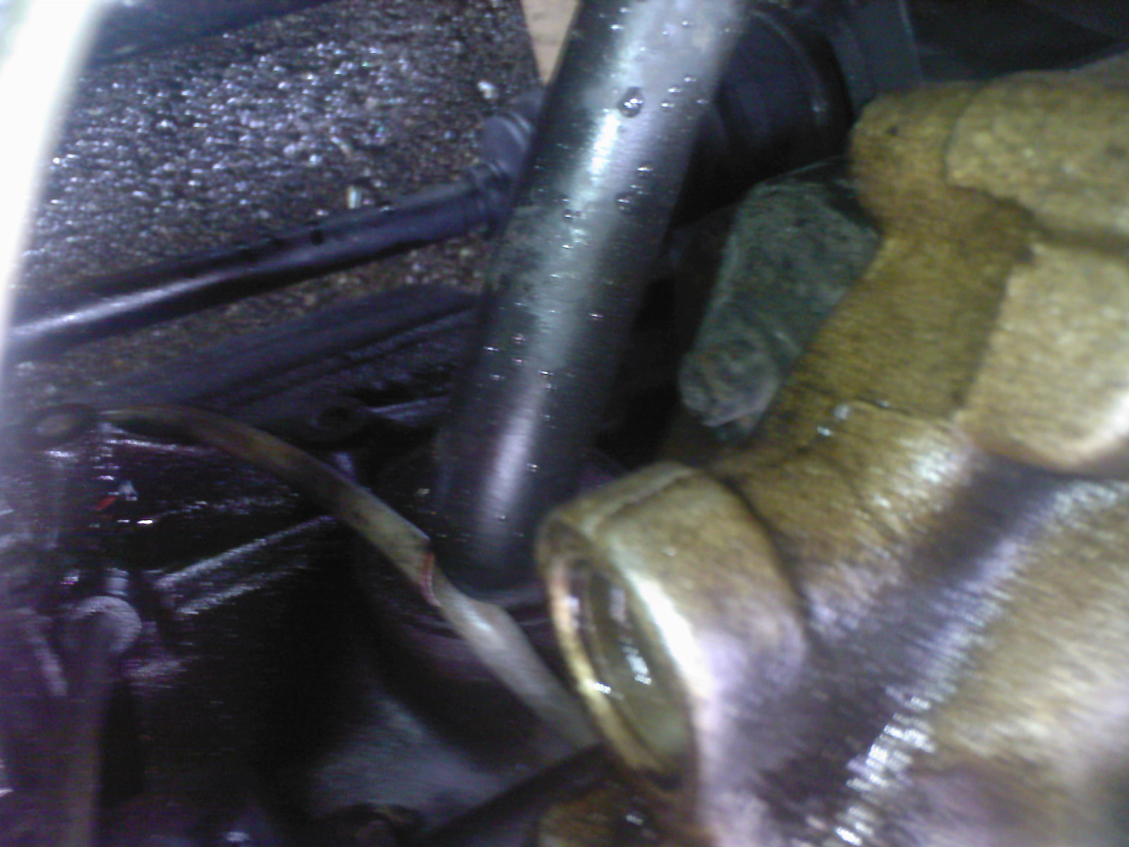

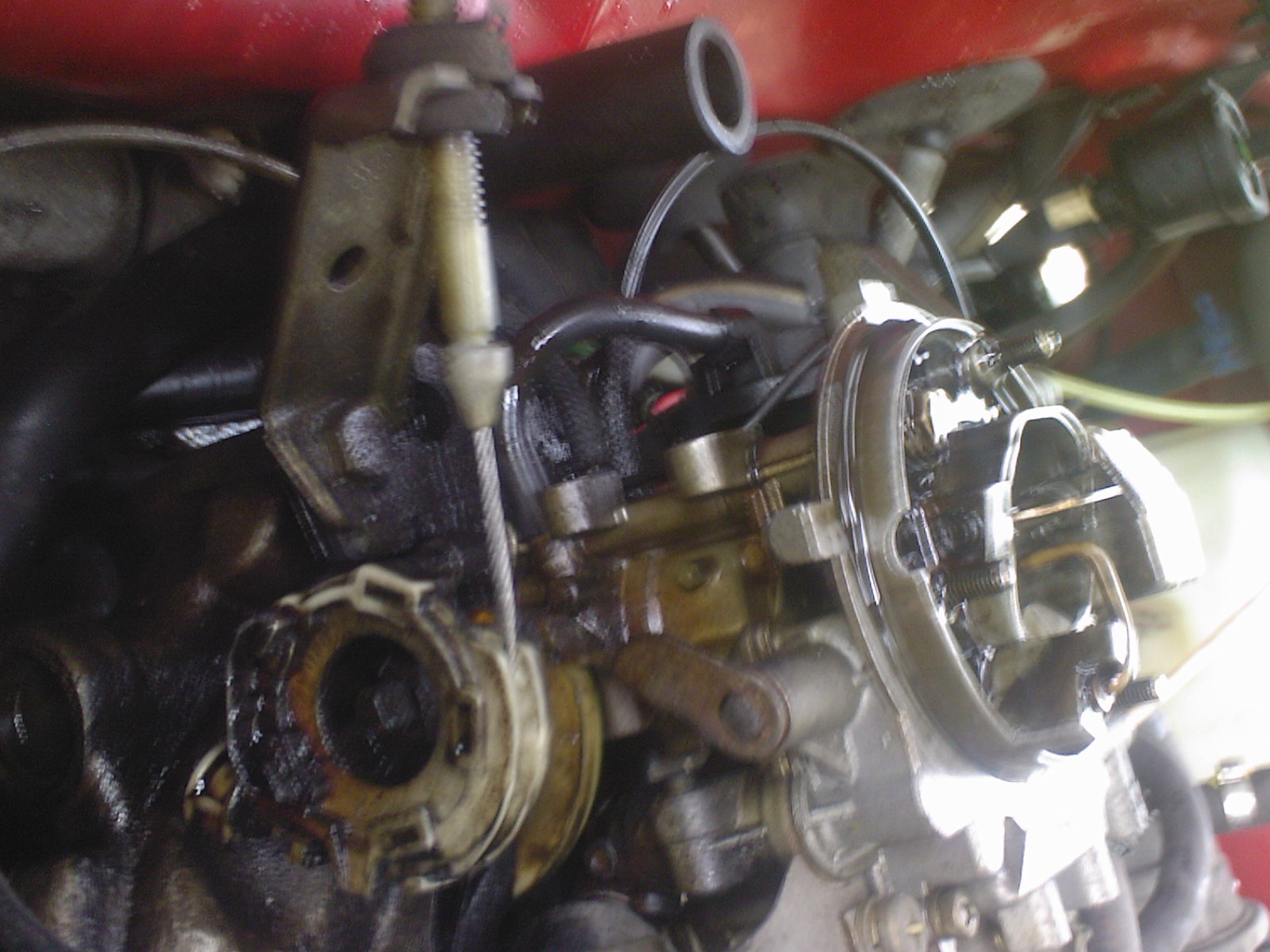

the pipe in the pic that run up in to the air filter has been "spitting/spraying" oil out!! this aint right is it!!! what can i do to fit it????
this is a prob as it is working it way back up the air air box and dripping on to the engine and smoking every wer!! it dnt look healthy???
**ok had another look and it seems to becoming out of the dipstick.. as well or just from there (prob just from there as that pipe is dry..)

sounds like you have a blockage somewhere which is causing the oil to be forced out the weakest points. its normally a sign an oil breather hose is blocked somewhere
Yea make sure the pipes aren't kinked or anything, excessive crankcase pressure will force the oil out from the breather and various other places
ty jon/hypo will do it tomoro.. while i change the oil and filter...

its normally a sign of a blocked breather, if you have to replace the whole thing into the back of the engine its a bit of a ball ache, people have been known to redirect the breather hose into a small oil bottle as a temporary measure, i hope for your sake its just a hose thats got kinked, needs cleaning out or perished. do a search there is a lot more on this subject on the forum that will help.
