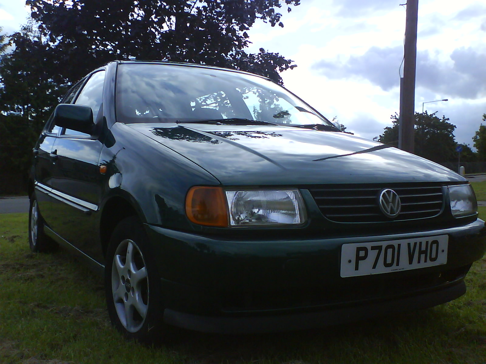

hi the at the front of my car which i have recently purchased their is a gap between the end of the bonnet and the grill and lights ! i was wondering if any one knew how i could get rid of this gap ??

there are 2 rubbers on the cross member.
they are like giant screws.
wind them in to lower the bonnet. However this may mean that the bonnet and wings no longer sit flush
