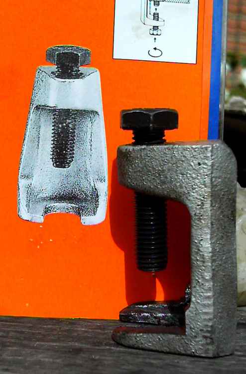

It finally worked using this cheapo splitter once I used a 'bastard' file to flatten the angled sides of the base.
Before I filed it flat, whenever I tightened the bolt the tool tilted away from the ball joint's screw thread end...
see piccy of the filed splitter.
I also used a big lump hammer to whack it into the gap between tierod and suspension mount, which split the old tierod end's rubber pillow and let grease escape, rendering the old tierod end completely unservicable, in the unlikely event that the new one wouldn't fit.
