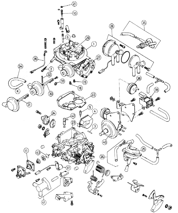

ok heres my next plan.
check voltages on all the wires....
replace as many vac hoses as i can
if non of these work ill cheat and give a tweak on the idle mixture setting

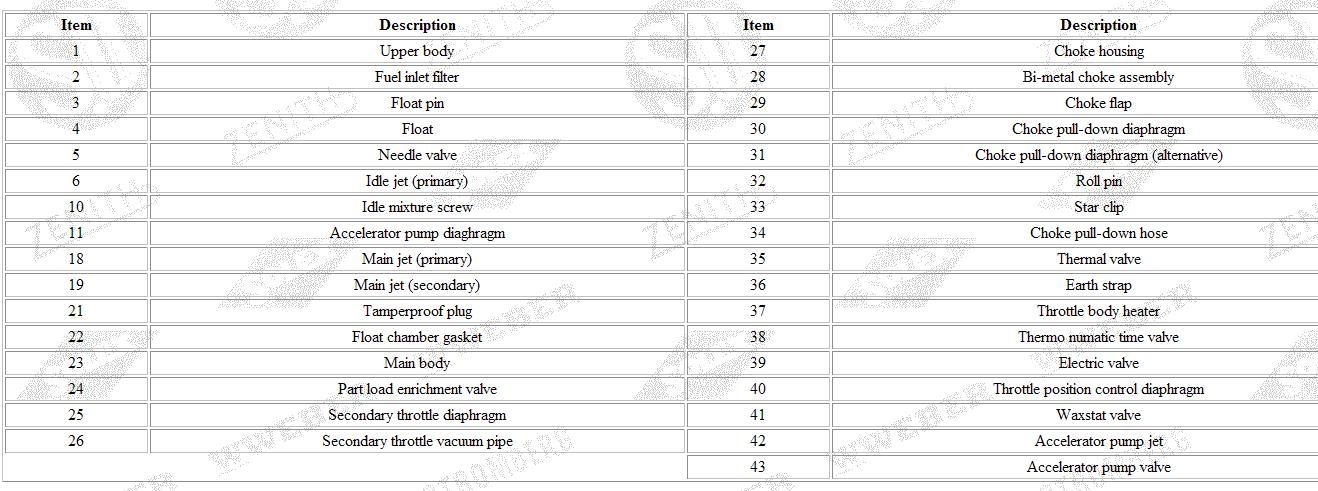

heres a blow apart diagram of the 2e2
