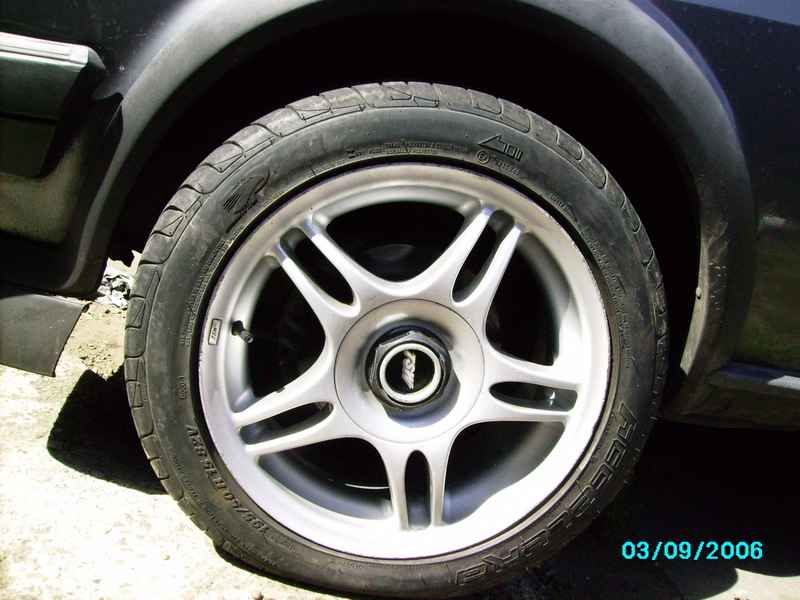

I bought som 15 inch TSW rims yesterday an they have 195/50/50's on which are scrubbing my arches like fook!! anyone any ideas what'll fit some1 must have done it!! Its a squareback polo by the way mk3

I need different tyres to put on the rims i have as the tyres on them are rubbin arches. dont know offset, no car is not lowered. Here they are.
What width are the wheels? What offset are they?
I dont know anythin bout this stuff mate, just grabbed em coz they were cheap. How can i find out?

On the back of the rims, there should be info saying width and size and probably offset
i had same size tire and same car and they rubbed like hell you have to take the wheels off and hammer the lip off the arch in only way to do it that is what it will be hitting. if your not to fussed just use a hammer but if you wanna minimise paint coming off then use something to hit on to
