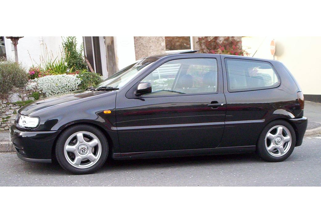

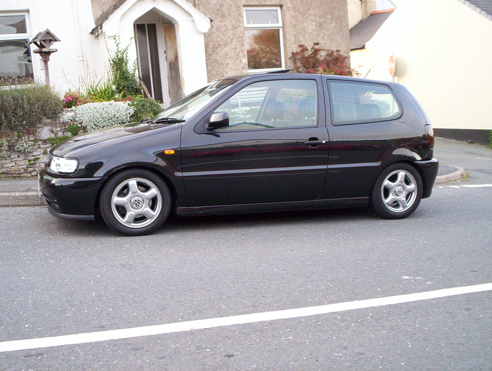

i'm need of some help and advice on me Polo 6n 1.4 16v.
i got coilover lowering kit, which i think drops 120mm, but when car is on the deck
the anti roll bar hits the underneath of the car just at the lower part of the inner wheel arch.
i have attached photo on the topic so PLEASE have alook to see what i mean.
love it lookin that low, but when i first drove it it knocked like mad and didn't
handle so well at front end as what i thought it would, must be due to ARB not having enough movement.
I jacked up car today(when i got it underneath!!) and with the wheel of the deck there ain't to much clearance anyway,.
SOooo don't really know what to do, in the photos i have actually raised the car about inch at the front,
but still knocks over bumps etc!
IF ANY ONE CAN HELP PLEASE MAIL ME!!!
CHEERS
DAN

stronger or poly arb bushes?
or not so low?
or not so low?
I have jacked it up bout inch at front, but stillllll really close! as u can see from photo of arb, its close with it jacked of the ground!

hi plp, just read through the threads which have been left, might have to look in to diffrent rollbar, 16vTej's idea sounds good, but i must say it has got bit less lately, but still bit sketchy at the front, could be my drivin!!
at least I'm not the only one that has this problem!! cheers chaps(and chapettes if any!!)
the photo is it nearly adjusted to low as it will go, jack it up the other day at the front end, but still knocks so may go bak down again soon!!
