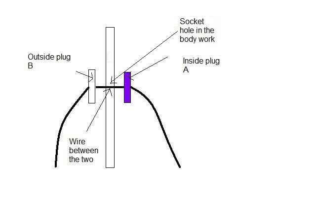

you can push them through to the inside of the car and pull them down enough to drill through the plugs.
Just undo enough of the underside dash above the footwells to give yourself the room. Thats what I did anyway.
I'll try that then mate. This is the picture I had from someone else's mk5 from Talkaudio. This picture just makes it look so much easier than it actually is...
This bit comes apart by twisting it off and then once you have the inner part of it inside the car your sorted.
Put a hole in the blank part of plug and thread you wire through. You are right, it is quite a tricky job but it will
look better in the long run.

This is how the wire was run into the car. Was prooving too difficult to run it through the molex plug, but this wire is barely noticeable at all, unless it is pointed out.

once undone, you push the purple part inside the car.
Pull it down and there should be a triangle shaped space in the plug.
Drill through it to make a hole and then look how the connectors line back up with each other
Put another hole through the other part of the plug in the same place.
Thread your wirer through whilst there still seperated, should end up with this.
Line your plug back up, pull the wire tight and twist it back together.
Job done.
Edited by lebon
