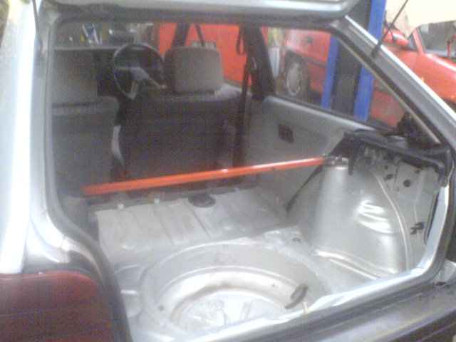

I made my rear strut brace!
Dunno if it works but it looks quite good, got a ire extinguisher to go on it hehe!
Tyre well needs to come out desperatly....

Upper bar useless on the back because there's no sideways flex - the shocks are remotely attached,all twist goes into the rear beam (there is floor twist,but you'll need a roll cage to reduce this).
