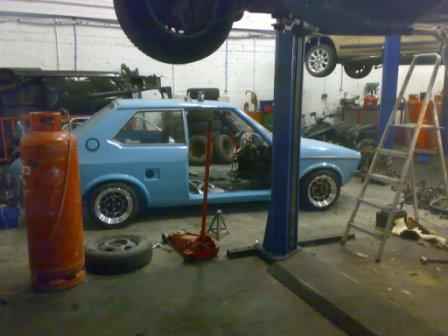

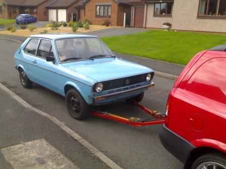

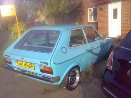

I bought this car off Phil J after seeing it for sale on this forum. The car had no MOT and Phil warned me it was rusty and had no interior, but I had rebuilt a number of mini's before so knew anything can be saved with bit of effort!!
She was way to far for me to go see, so I payed for it over the phone and sent out a car recovery firm to go get her 8) Which is much cheaper than you think by the way!

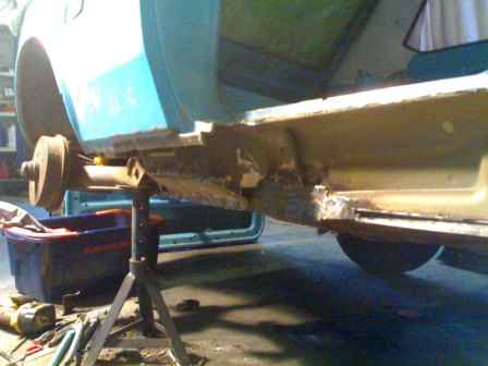

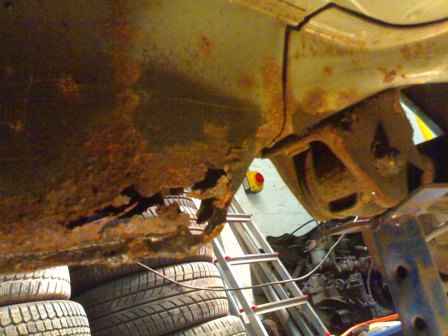

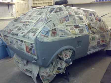

The car needed two new inner and outer sills, two jacking points, two rear arches, Inner arche repairs, rear valance, a patch on the boot floor and a patch on the drivers foor pan....Which took some time :shock:
I wanted to aim for a ratty looking polo as i wanted to be able to use and enjoy it without the hassle of polishing all the time. Iv rebuilt and cleaned everything that iv worked on (Such as the brakes and anti roll bar, petrol tank e.t.c) but left the front wings and valance scabby.
SO after I painted the new pannels (leaving the aged paint look on the rest of the car) and sourcing an interior, Iv been busy getting in back toghter over the last week.........Its almost done :-D

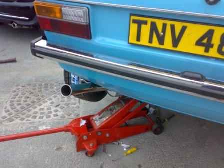

Tried to fit a stainless exhaust off a mini today - But could'nt get it to fit n had to settle for the bongo one :-(
But I did manage to drive it home from the unit its been in, I love driving mk 1 ' s!

car looks awesome! what exhaust system are you running? where did you get replacement sills/panels?
I'm running the bongo standard exhaust - Had a play mini stainless exhaust to fit but could'nt get it to fit :cry:

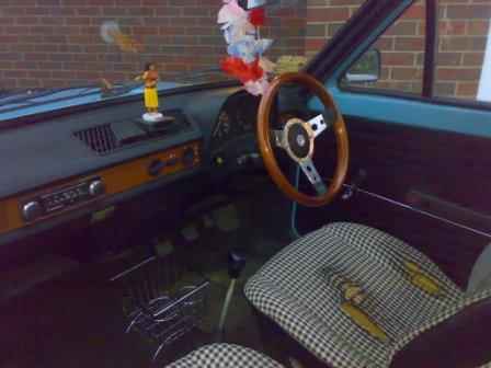

Love the interior, it's got lots of character
ahh you got a dancing girl on your dash! I've been after one of those! I'm gonna nick that at the next meet! just you wait! and you under dash tray! lol
Thats alright, I robbed your flowers round the rear view mirror idea :lol:
Have you thought about buyin wicker under dash trays they sell for beetles and tryin to get them to fit??
