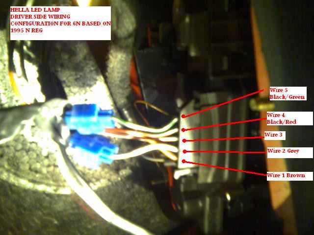

stil got problem drivers side does not work? tried swapin wires 4 and 5, and turning the socket around, do i have to swap the brown & grey wires? they are number 1 & 2.?

what colour should the wires be for 4 & 5? i swaped them but they dont work, for example when put tail light on the brake light comes on..etc.. stil does not work.
however i heard some models the wire should be grey and brown on the conector to swap. but they are number 1 & 2 on mine.
its just the swapping bit on the light with the wires that is messing up. did evrythin on guide and what you said, still no luck, but i have not tried swapping number 1 & 2 which are brown and grey.
but yeah would like to see pic of it if u dnt mind, cheers mate.
Heres a pic of how my ones are mate. When you flip the connector over and plug it into the socket the wires should be in that order.
On my one wire 5 is green and black and wire 4 is red and black. They might be different colours on your one though. Ignore those blue connectors they were already there for some reason i just snipped wires 4 and 5 and switched them round and its all good!

nice 1 fella, have a bash on it 2mz, cheers.
just to let you know mate finally got them sorted. all work and are fine mate. look great. thanks for your help much appreciated. :D cheers.
