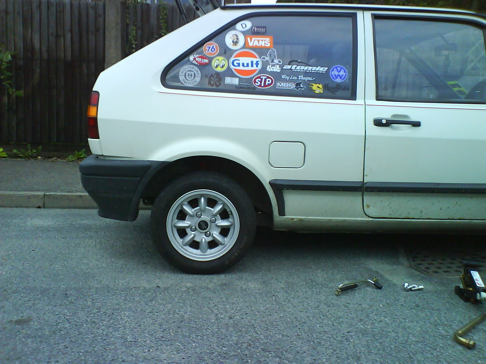

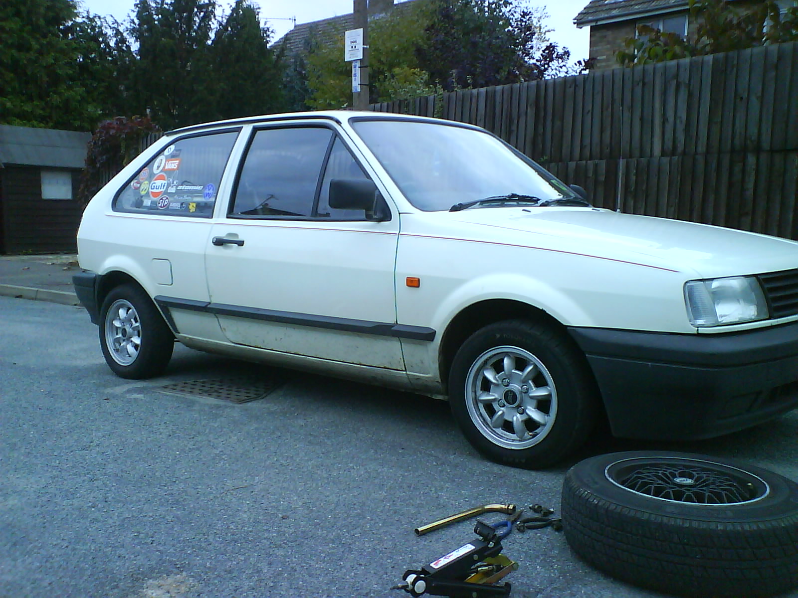

12" mini wheels? how can i move the caliper?
I have the wheels.
I have the wobble bolts.
I know how to cut down the metal plate behind the disc.
HOW THE HELL DO MOVE THE CALIPER???
Should i just bodge it and file down the metal (dodgey) or do i try and move it, or maybe look for a smaller caliper like maybe off a lupo or sumet???

Why did you buy 12 inch wheels? 13's would have been a better idea. You can't really move the caliper down as it has to sit in line with the disk...as for smaller calipers the Polo one is small as it is...
Lupo ones are 239 at the smallest, same as Polo.
If you run 13s with low profile tyres it screws your gear ratios right up, so I'm guessing 12s will be even worst. Plus you'll never get it low enough to look good.
Personally I'd just sell them on. I mean you can shave the caliper, but not massive amounts. Not enough to get 12s on anyway :lol:
I've looked into this. A competent engineers could get the bolt holes on the carrier shifted a few millimeters in order to take the caliper further in,and they could trim that few mm from the disc. Then a mild shave on the inside of the pad to clear the hub,and you're there.
But its alot of work,the brakes will be even worse,and you wont get insured.
They do fit...just, dont roll/move lots.
And tbh if i put it low enough it would scrape but it would have better acceleration and look sexy low.
