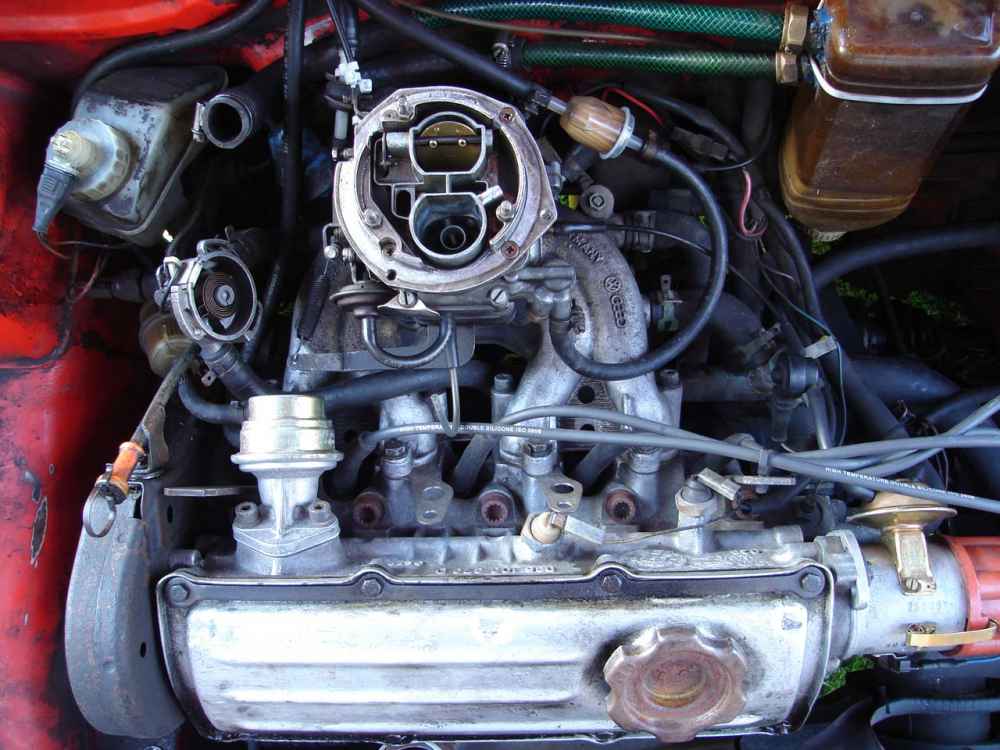

The GK manifold with a dehedgehogged heater plate. The pipe to the left was blocked off with a big fat gearbox bolt, as it is surplus to requirements on anything other than a GK, and the electrical plug on the right side is surplus to requirements too, so it was left in to plug the hole.

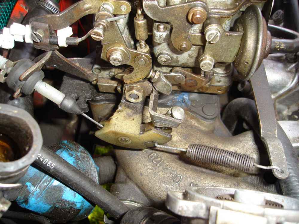

The throttle link of my DMTR. In conjunction with the adapter plate I used, not only did it collide with the GK manifold but I didn't have any good means of fixing the throttle, so I had to do some chopping to leave just the bits necessary for the choke mechanism, whilst using an old pierberg throttle bit and chopping everything except the cable linkage off, with some extra shaved off to properly snuggle up to what was left of the original linkage. You can sort of see in the second image, a mock-up of the installation.
