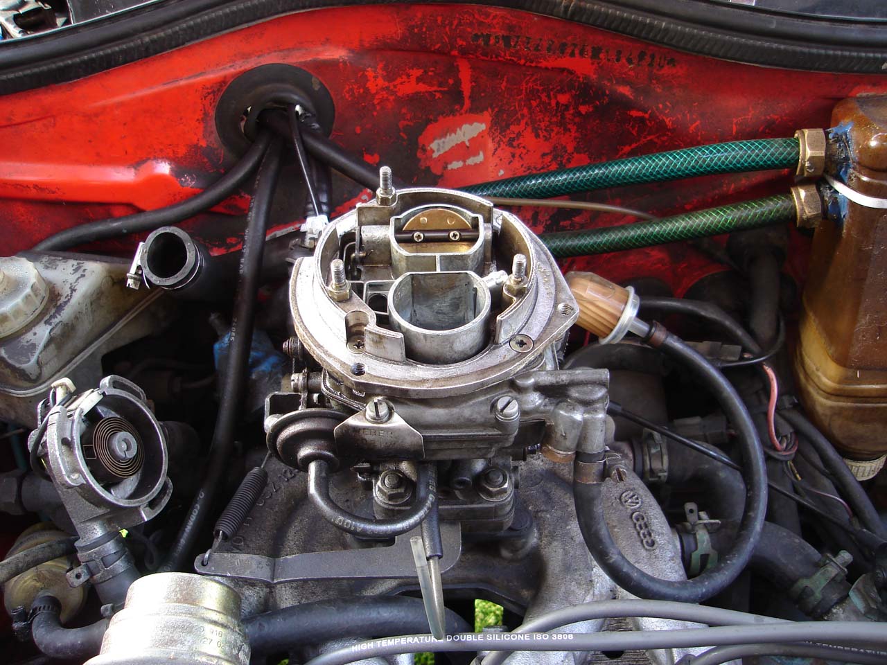

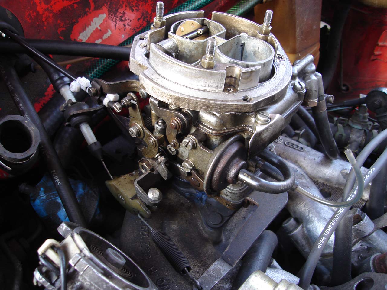

Right i took a few detailed pics of what came in the box. Didn't take a pic of every little bolt but just the major parts. If you need any more pics of anything i am happy to help and can easily take more pics. Also i will copy the instrucions, exploded diagram and parts list for those who asked for it. They can scan it and post it if they please....
Sorry if the pic quality is poor, can always retake any....
Hope this is of some help

still cant figure how the polo accelerator cable fits to that :(

on the proper polo set up...do you cut the nipple thing off the end of the acc cable then? or does it fit as per the pooburg
Demolover much appreciated matey, good reference to go from. :-D

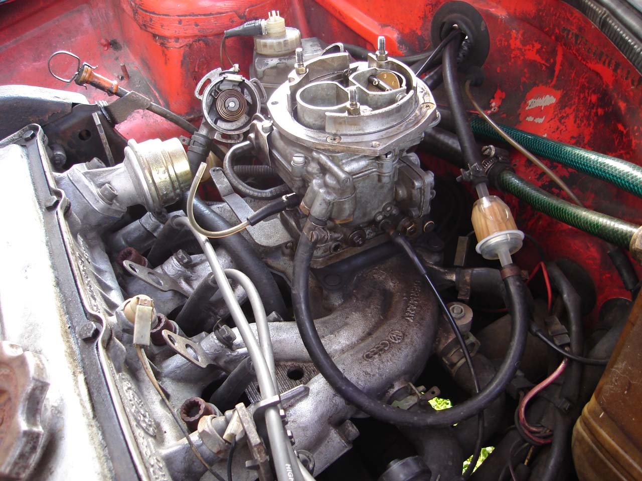

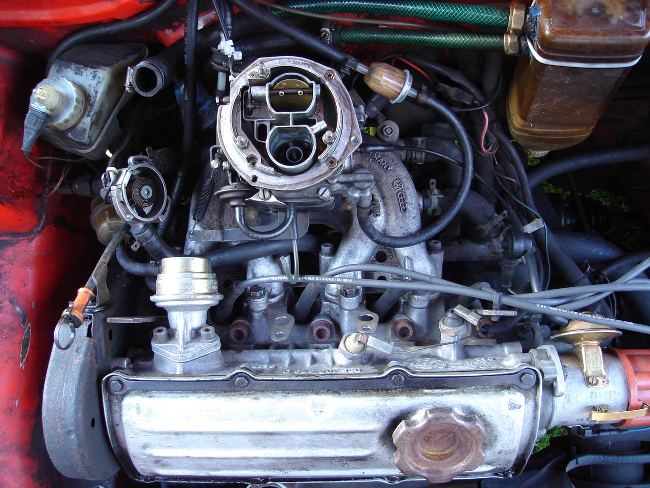

couple of pics thanks to hypojam
^^^ They are from when i first fitted the carb, a few things have changed since then^^^
look forward to the updated pics....they all help though

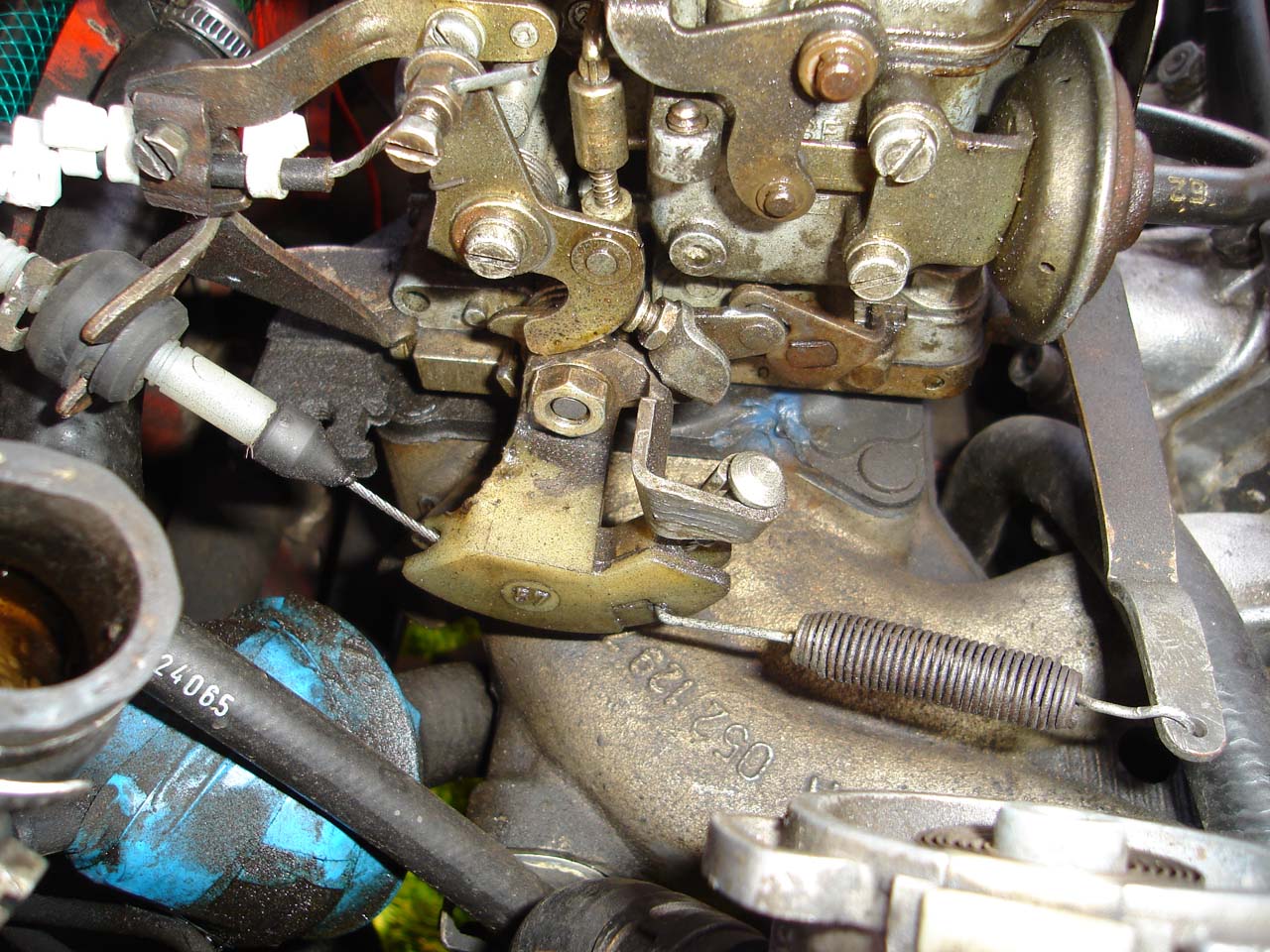

Recent Pics, It doesn't look too pretty but it all works spot on 8-)
Close up of modified pierburg linkage
is that a dmtr or dmtl?
any chance of a brief description on how you fitted the pierburg quadrant? was it a 2e3 quadrant you used? cant see how its been adapted
Edited by steveo3002
I haven't got any pics of the original pierburg linkage so its very hard to see what has changed. All i can really say is the pierburg bit was essentially chopped in half getting rid of the bit which had stuff to do with the pierburg choke mechanism then the weber linkage was chopped in half geting rid of the Weber's throttle linkage part and then the two pieces were combined so that the throttle linkage is down too the pierburg bit and the weber bit controls the fast idle choke operation on the weber
