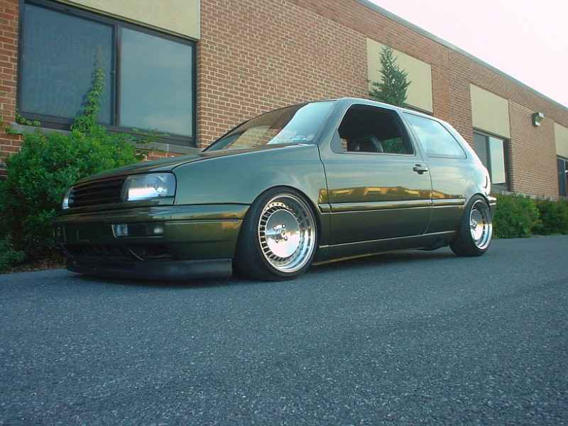

i had one on my mk3, that came out the passanger side and the 2 times i got pulled in it they never said any thing about it (and one of the times they were ripping my car to bits nearly :( ). that was just a straight though pipe from the center box and it sounded sweet, and it was on a mk3 lowered 80mm and never caught apart from when i tried to get up a big curb.

Well, a lot of mk3 people claim its to get clearance issues when running there car low but tbh I ran a full stock system on a kit that was harder than most and was fairly low and I never had any problems.
Took a while to work out how to fit it properly and it fell of plenty of times before hand but being persistent worked fine in the end!
