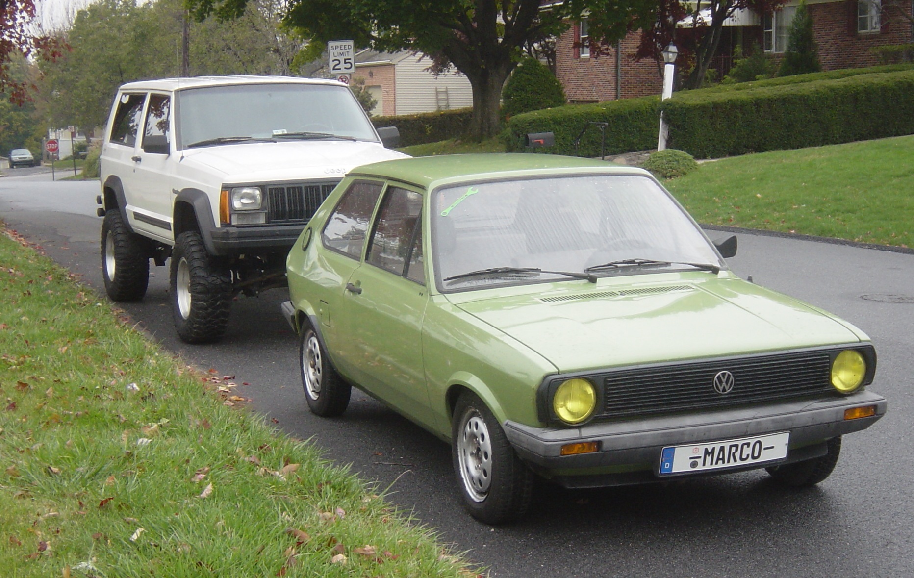

I think to put the 2L brakes on I would need an adapter. They are girling 54 calipers, not VWII. I want to stay small enough to run 13" wheels. So the 2L brakes aren't really an option. With the rear disc conversion I have done this on Golfs before. Is it the same procedure for a Polo. What do I use for ebrake cables. Maybe cables from a mk1 GTI?
This is DeezUU's old car. He has my old golf now.
Sweet car :drool: When the previous owner had it was it sporting ATS Pepperpots? Looks familier..
Possibly my fave VAG colour 8-)

He did have pepperpots on it. He also had weller steelies which I have now. I am not sure if I am going to use those or come up with something to make it my own.
