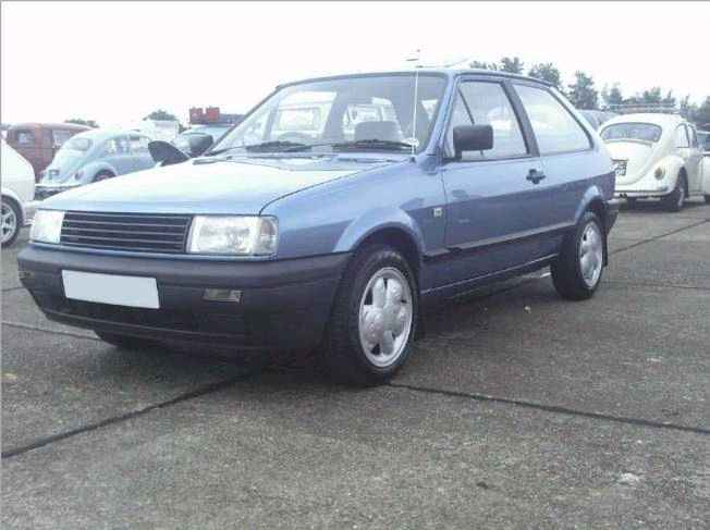

I put in clear indicators on the front there only to find the bulbs are clear too, now I'm considerin getting some sort of long side repeaters or something similar to those on the front of a mk2 and fitting them to the bumper and just modifying the wiring to the current indicators to turn them into side lights. Looking at something like these for the front bumper:
Edited by Chris_McCartney
Worst photoshop I ever did do.... trying to work my dads laptop and Paintshop Pro 9?! Give me Paintshop Pro 7 anyday, its the daddy of them all!! Anyways this is KRAZY*K's car its just the closest car on here to mine until I get a nice day for some photos.... smoked BMW side repeaters fitted onto the bumper...
