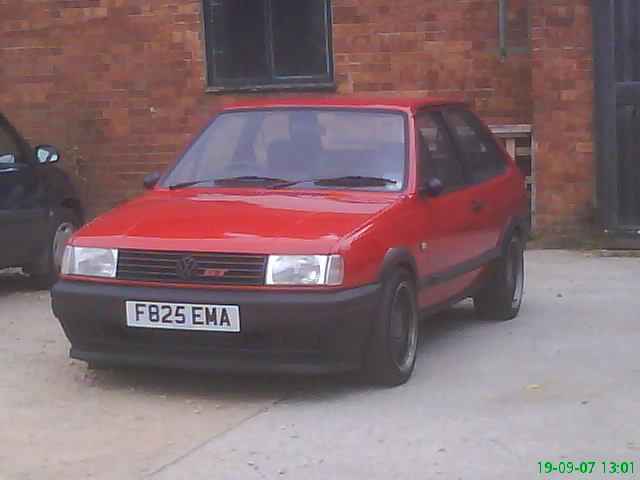

As you know i killed my green cl so here is my new polo. had it about 4 months now.
She's come along way since i got her. She was completely standard and un-molested till i got her home.
The day i bought her......
Spent about 30 hours polishing her to get her red again....
Engine...
1.6 8v AEE (GT MPI) conversion
285 Piper cam
4-2-1 manifold, de-cat exhaust (soon to be up-rated to 2.5" pipe)
Golf afm
bigger injectors
Chip
Suspension...
Lowered 40mm all round on boge springs
up rated shocks
Brakes....
260mm Vented front disks
green stuff pads
rear is standard at min
Styling...
15" BBS alloys
Audi door handles
De'badged grille
front splitter
Private plate
Shes just recieved a full re-spray and a smoothed tail gate so i need to get some new pictures taken.
Any comments welcome...... as long as there nice haha
ema x
