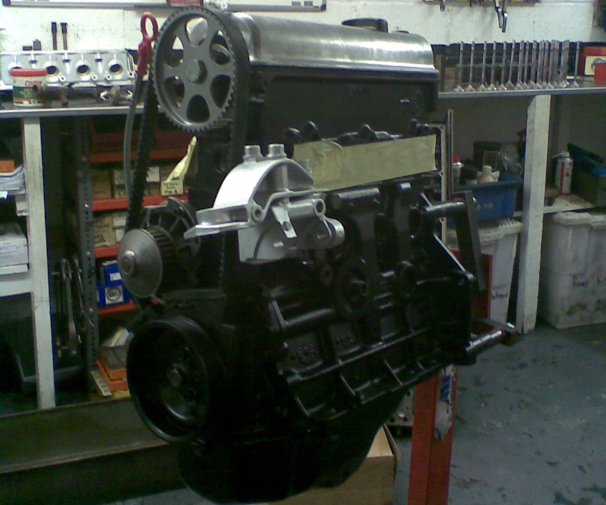

Beast!!! Nice spec there. 1W blocks are just different stroke right?

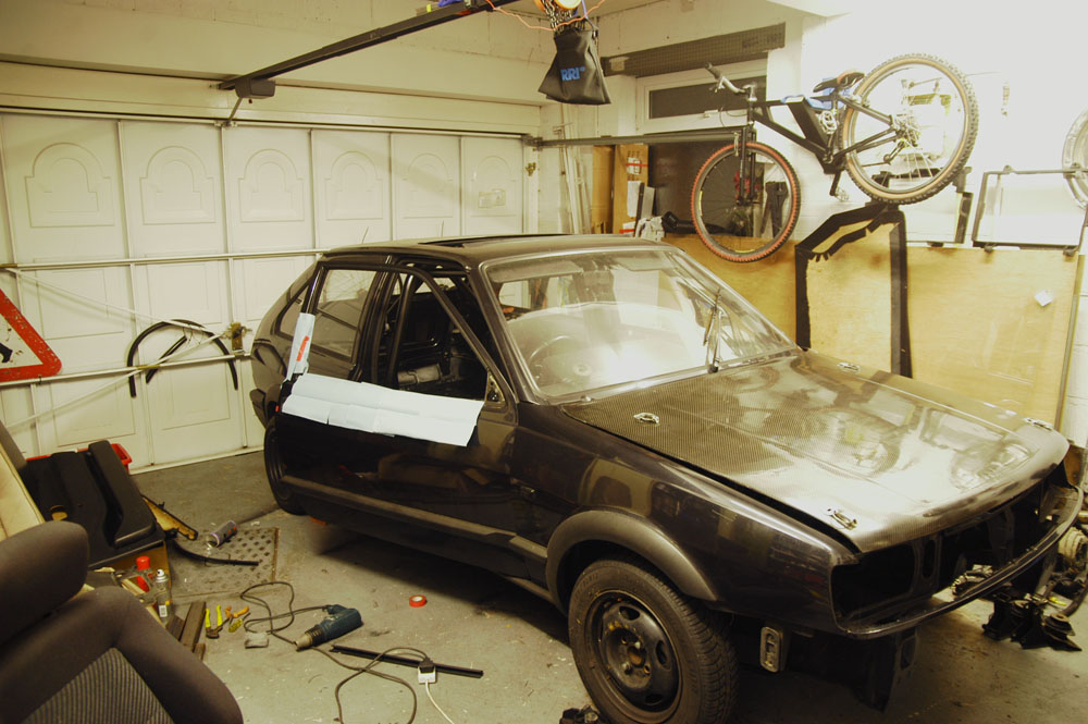

Very nice spec. How much of a pain was the omp cage to fit?
Different crank, rods, bigger clearance for the bigger crank and rods, no provision for knock sensor, different head bolts
also has oil jets and it does have provision for knock sensor.. now
Giorgio - a pain, i wouldnt want to fit it to a car i wasnt prepared to have a blat with the welder on - that said i have a sunroof so all the legs had to be chopped down, fitted into a non sunroof i think it wouldnt be too bad.

update: got the fmic all sorted and a new lower support bar made up, also drilled and tapped out the feet for the front half of the cage, tidied up in the engine bay a bit and as soon as i get studs for the turbo will see about mockin up the exhaust.

quick question.. what does the 1w bottem end come from ?
Seat Terra van. This car is the ultimate sleeper Currie i love it :thumbsup:
