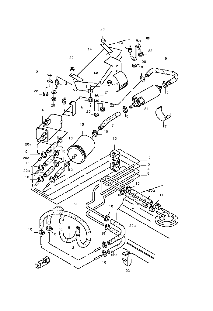

check the fuel lines are on accumilator ins to ins and out to out
yeah they seem to be on fine.
the tank return to top on accumilator facing forward
tank to accumilator middle facing foward
return from injector rail to bottom of accumilator facing forward
outlet at rear of accumilator to hi pressure pump
make sure that pipes to injector rail are correct return pipe is connected to pressure regulator and pipe from pump is onto black pipe on injector rail
then check you have a spark let me know if you have or have not
