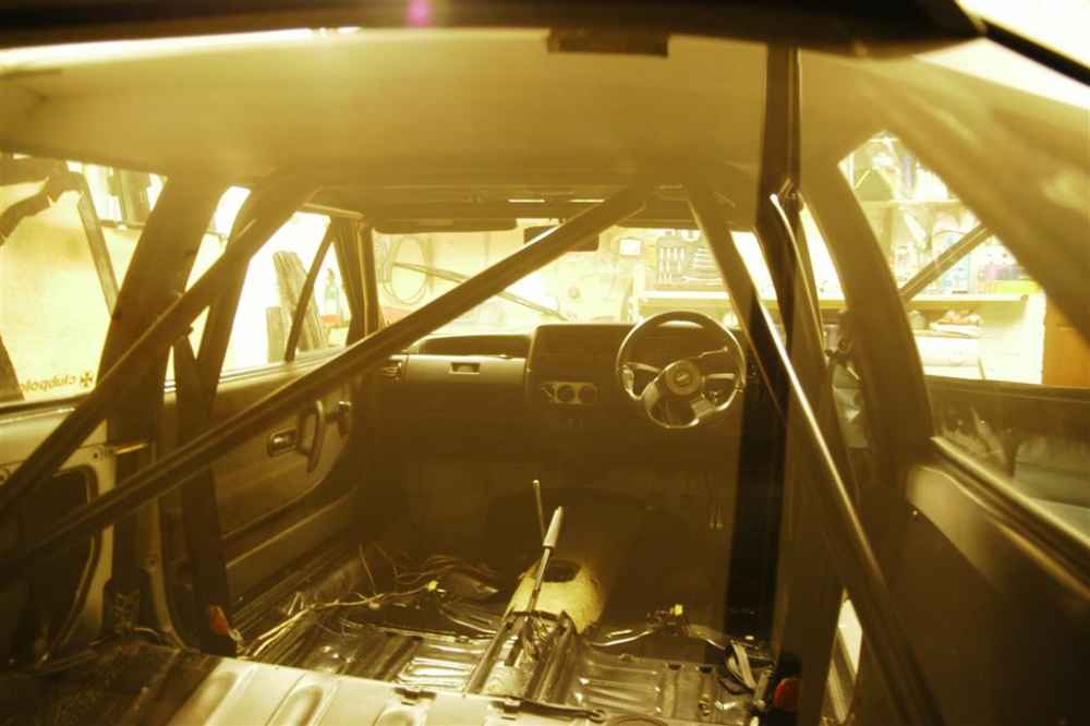

None of the OMP cages are a great fit... but unfortunately they're the only cheaper ones around for a lot of cars.
Had the choice of paying £250 for fair fitting 10pt OMP one or £500 for a 6pt pretty good fitting safety devices one in the 205. Went for the OMP.
yeah wasnt really looking for omp, would prefer a custom made one then atleast i know it will fit properly!
What is ment by the cage not fitting properly?
My one is nice and snug! I donk know what it was to fit tho.
calm down mk4 boy, we're tallking mk3s here. the mk3 cage by omp is one of the poorest fitting cages i've ever seen

I don't think it's just mk3 polo ones, I was talking to a few french hatchback owning people at a track day and they said they thought OMP cages were shit too and that the mounting plates quite often have to be modified or re-made. Pretty much the same things I've heard about OMP cages for mk3 polos. I guess they just make them to fairly poor tolerances so it's pot-luck as to whether you get one that fits well right away.
I've got a Safety Devices cage in mine and it's great. But I was lucky enough to get it just before the company went bust and restarted as "Safety Devices International" as after that I think they put their prices up and have stopped making some of the less popular cages, which will include the polo one no doubt.

I had to fiddle about with the mounts big time. Load of chopping, adding metal to bits etc, but it will now go in at least!
