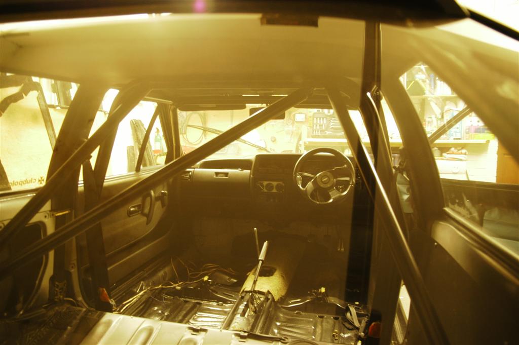

well, its a really baggy fit into the car, all the joints are bolted, its generally horrible and ill fitting!
  • Replies 58
  • Views 605.6k
The 205 one has a joint in the middle. The thing is in a lot of cases it needs to be split in bits to get it into the car! Plus a properly sleeved and bolted joint is as strong as a welded joint.

meh the OMP is better than nothing in my eyes. I'm happy with mine.
currie, could you post some pictures of yours please??
how easy was it to fit?
meh, got no good pics yet cause theres no light in my garage.
when i get it out the weekend hopefully I'm gona give it a good wash down and get a few pics.
oh and with regard to fitting. if the cage had been designed to fit my car I'm sure it would been easy but numpty here neglected to realise that he had a sunroof at first and pissed around for hours wondering why it didnt fit!
with 2 inches off each leg it went in fine. BUT i agree with what some people said about the plates, they werent exactly contoured to the floorpan but as i was cutting mine down i just welded the rear in and managed to leave the front stock height.
i wouldnt say it is do able without a welder though cause the fronts need some angle putting in to sit on - as you can see in that 205 that posted.

yea pinchy, the fronts are bolted onto L section about 8" long, the rears i cut some small L sections to weld up into the corners which gave me about 3x the load spreading and also to different directions and the rear stays were welded onto some 3mm plate about 2"x8"
I'm confident i have done a pretty neat job.

i am happy with my cage, i picked it up off ebay for £170 so dont feel like i have done TOO bad, as pinches says, there are areas that it is a bit 'baggy' but its only the front bar across the top of the screen that notices - just cuts out a tiny bit of the viewable area half a sunstrip apx.
i am more than happy with mine for the money [less than 1/5 of the price of a custom one and 1/4 of a safety devices. the only think i want to do to it is weld in an extra bar in the 'strut brace' position to attach harnesses to [if its not too high] and one between the B-pillar legs at floor level.
might look at getting some door bars but really i am trying to keep it 'fast road' not track setup ie, easy to get in and out.
