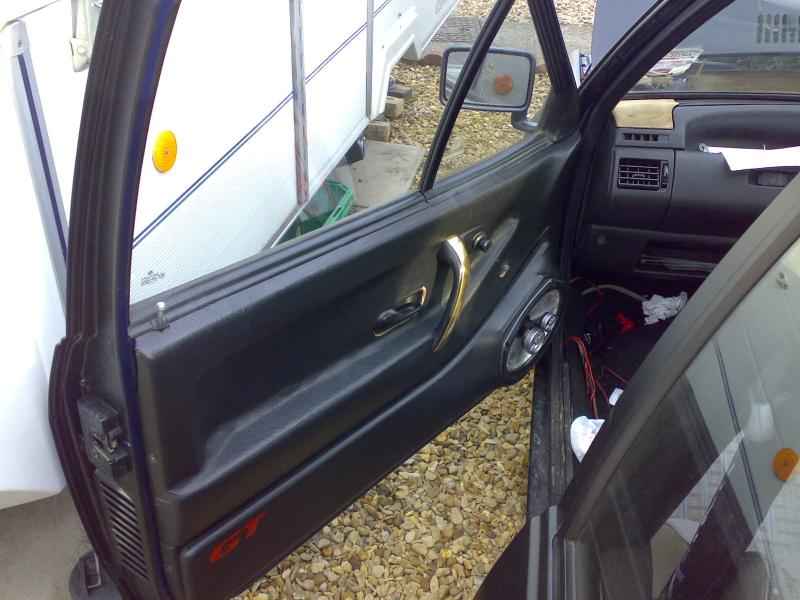

Had a crack at door speakers
Went to B&q and picked up some mdf, have my 6x9 in my parcel shelf which i wasnt too keen on, as there on display and didnt want some piki to come along and smash my back window all for a set of 6x9. So made a template, and with a few nips and a few tucks, managed to get it fitted. Heres the first stage, next will be fitting some material/carpet. or maybe a retrim. hmm anyhow yeh, doorpods for £9 the might not look as good as the pro one's but £171 cheeper :)

look good, how do they sound?
alot better now i cut a hole just behind the cone. i though with them being inclosed they would sound good but they sounded terrible, was all distorted. After i cut the hole sounded alot better. May add some components aswell further along.
can you still wind your window down? i used to run a set of amped 6x9s in the front and a pair of 12" subs in the boot, was loud as fook!
yeh, but needs spacing out a bit.

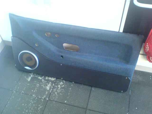

I been doing a bit of DIYing over the past few weeks too, you must have used thicker MDF than me, mine clear it fine. just finished the 1 so far, looks pretty alright for like £8 worth of MDF, £8 black vinyl, and £4 for screws and glue... Thinking of spraying the speaker grille surrounds black but leaving the silver InPhase logo on them... 17cm speaker for the record...

looks good man, i fitted the other today and the winder clears it fine, i think the 6x9 is still pressing aganst the card at the back, as i chopped more away on the other side. Also i chopped a bit off at the front were the dash tuches as it looks like it squeezing, and dont really want the dash shifting over. Have you fitted that door card yet mate? also have you cut any holes in the back were the cone is?

heres mine, bought them from here a few weeks ago, aint turned up yet, hopefully they will soon
^ they look good ot too keen on 6x9's personally though and not sure about them ebing in the door but if they work for you thats all that matters
Looks good scott, get some carpet/covering on them and your done.
My attempt in the old olop...
Hey mate, had a go fitting them and after sawing the ends of the screws (far too long) they fit fine, next all I got to do is drill the holes and get the rubber grommets, but I gotta say tonight I'm far too pissed too lol.
to be honest, I'm not sure if I'm going to like them either, if i dont ill get rid of em

Nice one Scoot, trimming those in leather or something, will be easy as.
If u need help just aks me mate...U saw what i did to my old 106 :)
