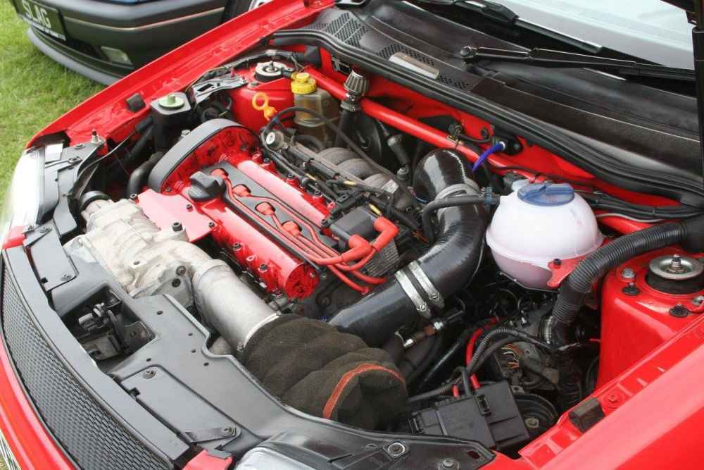

Hi all, I've had my polo since i was 17 and loved every minute of it. I've been wating a long time 2 put some pics up on here, but i wanted the engine 2 be nearly finished when i did.
so here u go and hope u enjoy.
Engine:
1.4 16v
Eaton m45 supercharger, 5th generation with Teflon coated blades.
Heat rapped stainless 421 ehaust manifold
Stainless cat back
1 mm decom plate with 2 head gaskits
Port'n'polished head
Bigger valves
Machined valve pockets on pistons
Uprated piston rings
Cat cams
Exterior:
FK coilovers
Porsch teledial 6j on front 7j on back
GTi splitter
Smoothed boot
Rounded bonnet
Grill
Rolled arches
Interior:
Standard
ICE:
JBL front speakers
Still need 2 get a few bits and pieces for the engine and the next big thing is 2 get it remapped.
I hope u have enjoyed looking through my pics and looking forward to the comments thank u. Tis

cheers, i would like 2 say i did do it myself but i didnt. i had it done in Haverhill by a compony called Taylor motor sport. i did put a hole in my pocket but it was worth it.

it was the 75 bhp but i have the intake manifold and throtolbody off the 100 bhp other that that i dont think there is any think els that is diffrent except the injectors but i will need bigger ones than the 100 bhp.
