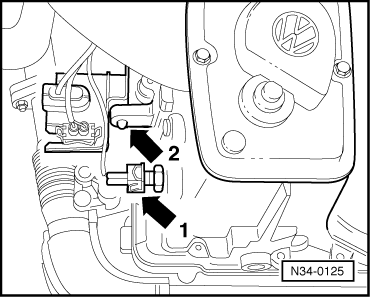

I also thought to take a photo of my gearbox while I was in/around/underneath the car and it's clear that it's been leaking over time. I didn't, however, manage to fill up my gearbox oil because I couldn't fit my drain plug hex bit in past a bracket holding wiring and plugs! Not really sure how to get around that...
Unclip retainer for connector out of eye on gearbox (arrow 2)post-36925-0-15457400-1427743780_thumb.p
Ideal, I figured something would just pop out, but thought I'd check first! I'll get it done soon. :)
The gearbox oil leak looks like it's probably came from the selector shaft seal
I understand that's a fairly common one? How difficult are they to replace. I don't want to put much more money into this car to be honest, it's becoming a right money pit.
It's not really economically viable to keep spending on a car that I feel is just gonna let go one day in the not too distant future.
Ah brilliant! I'll have a look at that when I'm on the pc next. That's not too bad for the seal, I'd say £4.95 isn't going to make too much of a dent. [emoji38]
