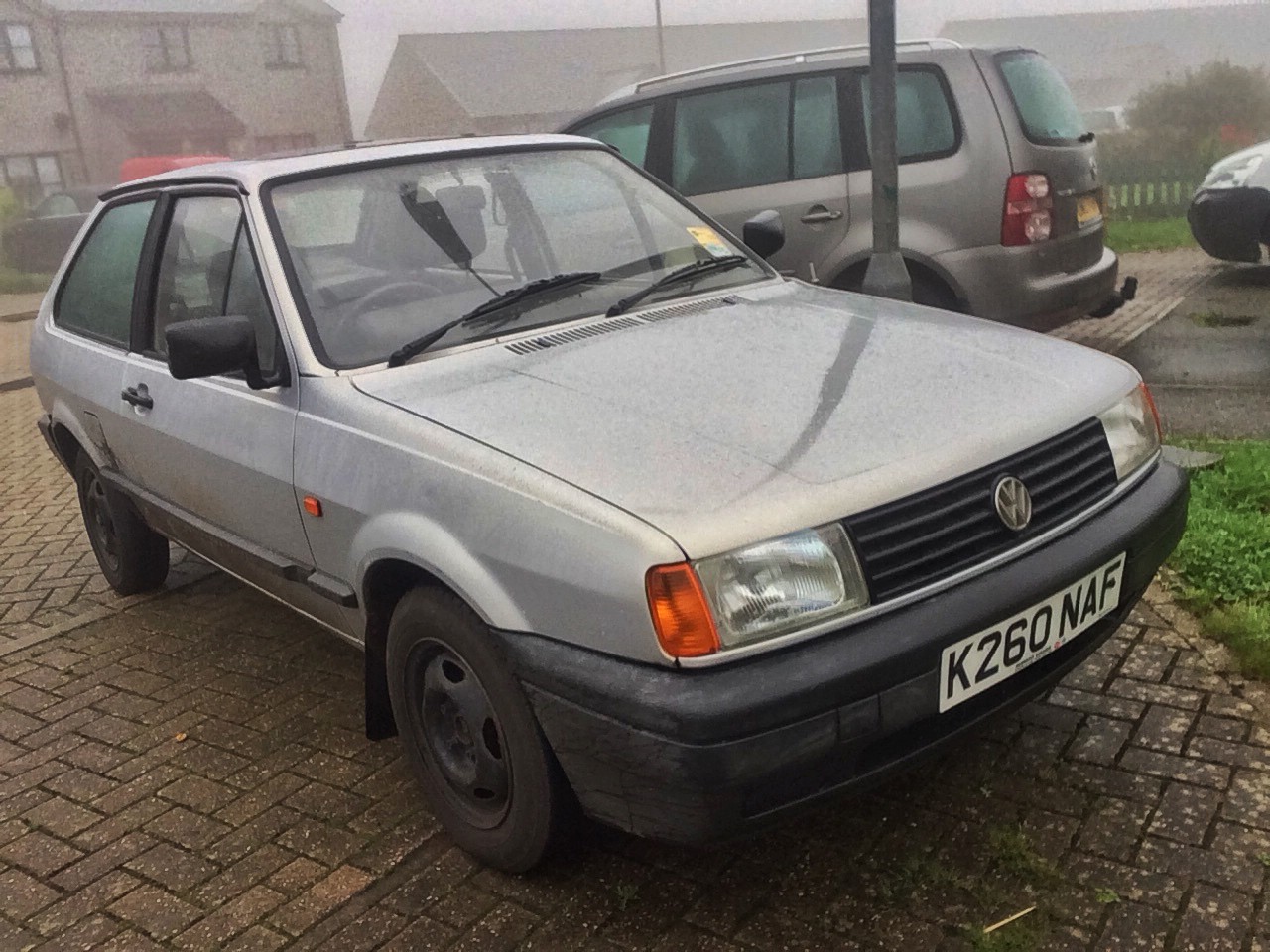

Hello there! After a lengthy time away from Club Polo I return with a 2f Coupe! Always said I’d get one. ?? Some of you on here will remember me from a couple of years ago, I had a 1.4 8v 6n, then a 1.6 mk2 Golf and also a 1.4 16v 6n. All the threads are probably still on here!
Story goes as such, I’ve been driving a 1.8t Leon and I’m facing the prospect of motorway miles, so I was actually looking for a diesel. Browsing the marketplace on Facebook and I see an advert for a 66k miles 1.3 Polo Coupe for £400. Messaged the dude and had a bit of a chat and decided it was best to go have a look. It belonged to an elderly lady who bought it brand new from the dealer and unfortunately recently passed away. Now, the paint/bodywork is really quite tatty and needs a lot of fixing up, but it’s all still very treatable. It desperately needs a new bootlid! The important thing is that, after a bit of haggling, I’ve bagged myself a one owner from new Coupe with only 66k genuine miles on the clock. Even still has the original dealership plates on it! The dealership doesn’t even exist anymore.
It’s the 1.3 AAV (I think) motor with a 5speed 8p box. It was a little reluctant to start as the last time it ran was the beginning of August when it went for its MOT and its sat ever since but I coaxed it to life and drove it home and by the time it had warmed up it was running brilliantly!
The plan for this week while I’m off work is to gut it and give it a good clean up inside out and go from there really. There’s gonna be a lot of tapping and coaxing dented pieces of bodywork back into shape as old dear (RIP) clearly liked driving into things.

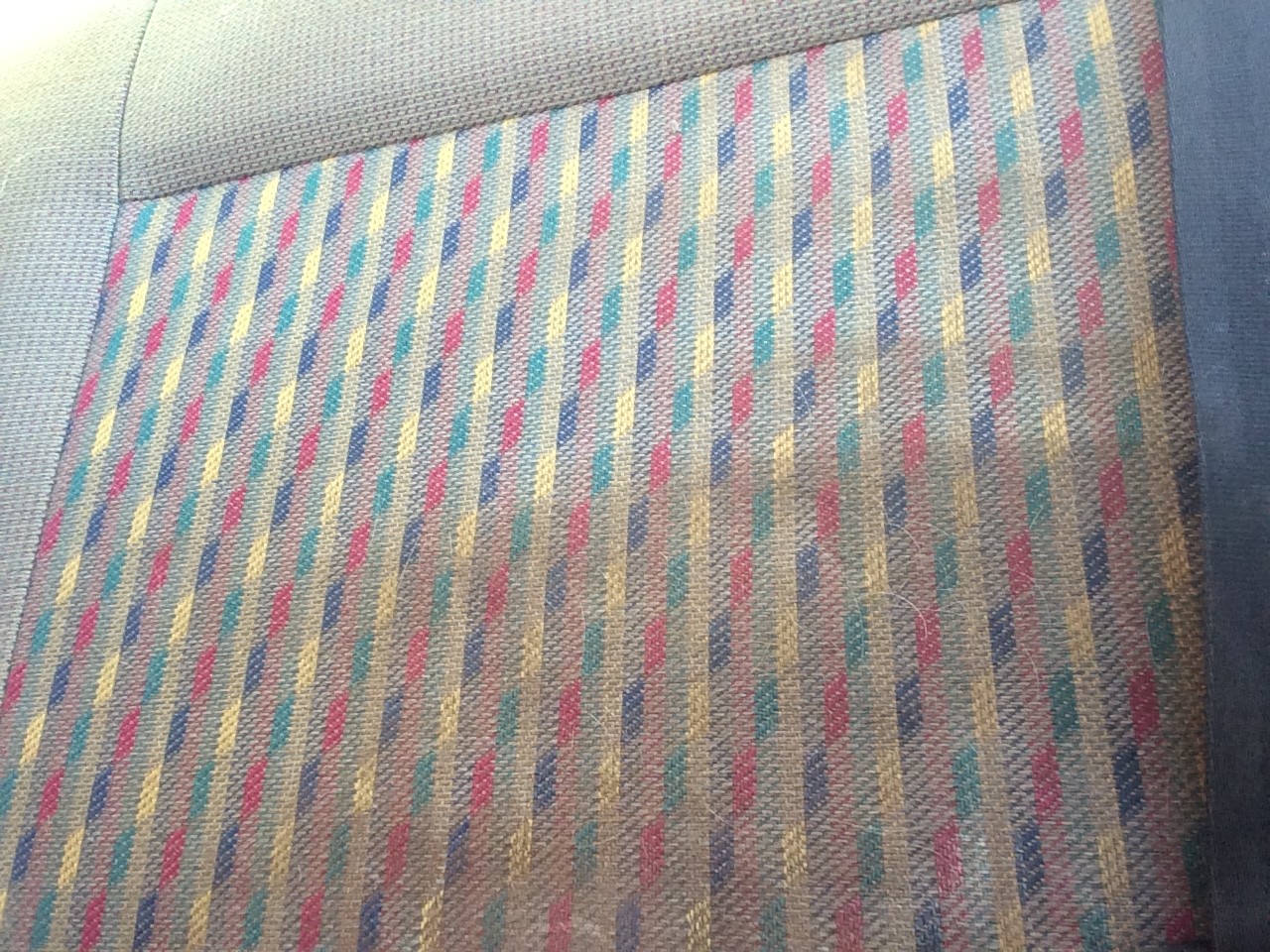

Had a go at getting the interior a bit cleaner today as it seems old dear and her dog just used the car without cleaning it once in 25 years. Didn’t take many before photos but it was completely hanging. I think I’ll be on the look out for a nicer interior but I couldn’t leave it as it was.
Rear bench is toast so will be looking out for another of those.

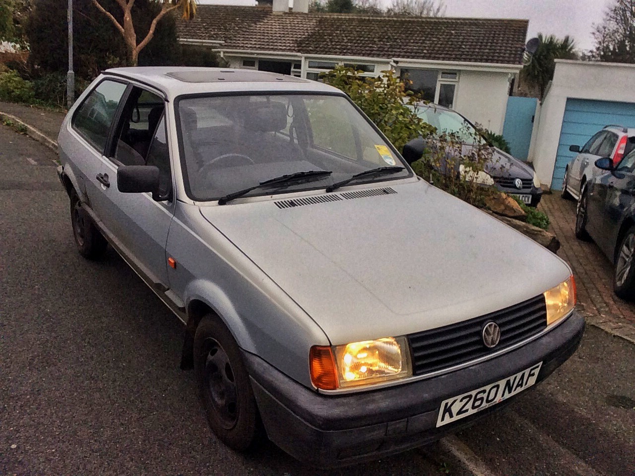

The hunt for a bootlid has commenced. So far the closest one I’ve found has been 320 miles away. ? I’ve been offered one locally with no glass but I imagine swapping the glass might be a pain?
The Golf is a sore subject, I went through some personal rubbish and some things came to an end, and I had nowhere to keep it. So it was sold for peanuts as I didn’t even have the time to put it back together and slap an mot on it. :(

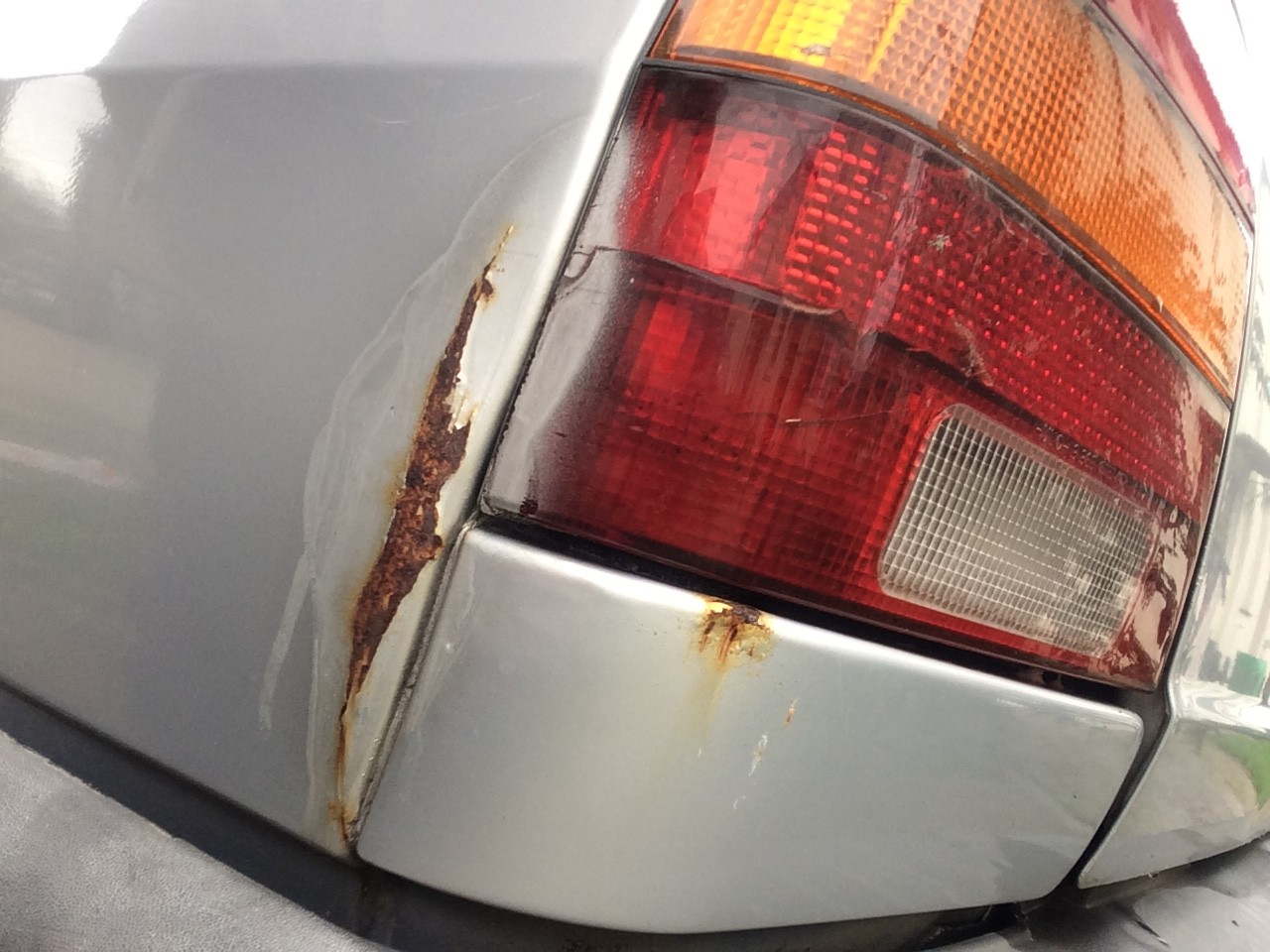

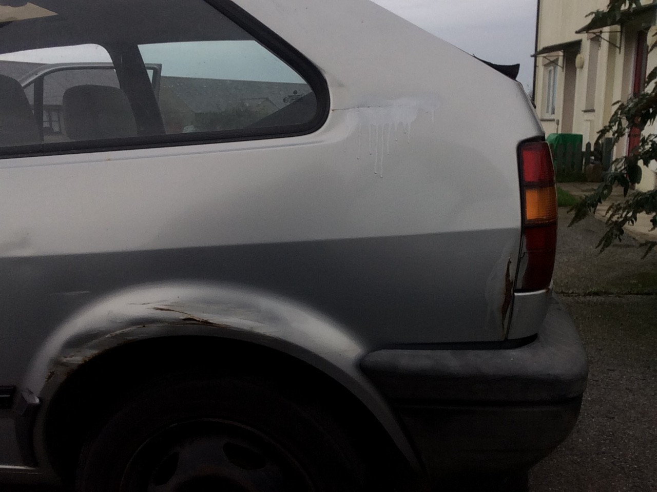

The Polo is a good little find for the price these days though and will hopefully clean up well. I’ve got some better pictures of the extent of the “damage” now. I think old dear quite liked driving into things, and her or someone seemed to think just squirting a blast of a rattle can would sort it.

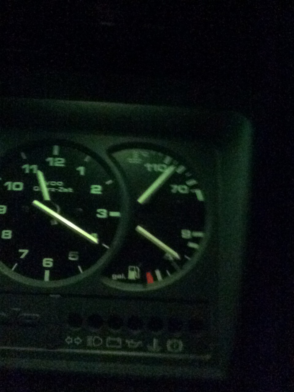

All rectifiable though. I’ve done 52 miles in it since I chucked £20 in and seem to have used about £2, as per the last photo.

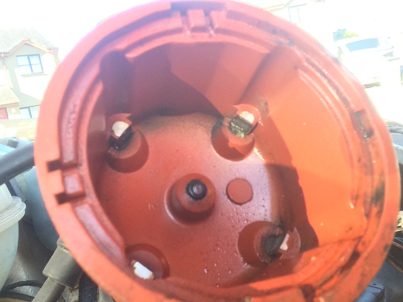

Hit my first few issues with the car in the last few days. Went out to it on my first shift back after 8 days off, car struggled to start. Cranked it a couple of times and it fired, thought little of it. Went to pull away, pressed the throttle down... only for it to completely bog down and have no power whatsoever. Tried to rev it a few times to the same effect. It eventually eased off and seemed like it caught it's breath so off I went. Changed into 2nd and... completely bogged down again. :unknw:
Puzzled, I headed back to my house in first gear and got out and had a look. Unplugged blue temp sensor, idle dropped a bit and still ran. Unplugged Lambda sensor and ran but rough. Once it got up to temp it cured itself and was fine for the rest of the drive. Had the exact same today, albeit seemingly more reluctant to clear it's throat, so to speak.
Most logical thing I can think of is moisture under the dizzy cap, which is then curing itself once it's warmed up?
I've ordered a new cap, arm, plugs and a fuel filter as these are the most immediate things I think could potentially cause the issue. Oil and filter were done recently. Also got a stat housing, coolant and a stat on the way as the housing has a slight leak once it's run up to temp.

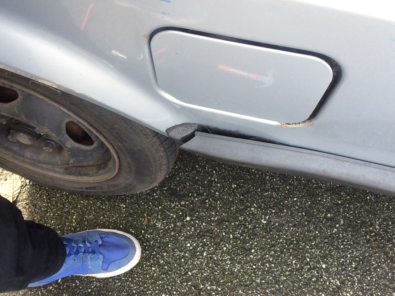

So today I gave the bumpers a quick attack with a heat gun. Well, I say quick, it actually took bloody ages but hey ho. I wouldn’t normally recommend using a heat gun as they do tend to make the plastics fade a bit quicker in future, especially if you go too hard on them, but I don’t plan on keeping these bumpers as they’re rather scratched and dented etc. But these do look a lot better for the meantime.
I also tried to pop the bodywork back into place by the fuel filler flap as there was a bit of a crease. I sort of achieved what I intended? :lol:
That's a massive improvement. I have had a go in the past with heat gun but got fed up and gave in. :-(

I really wanna source better bumpers so doubt I’ll do much more with this ones. Also I think my running is more than likely gonna turn out to be the dizzy cap because this ones a state. Moisture spots in the cap and the contacts are corroded as hell.

Did a few service bits yesterday. Changed dizzy cap, arm, plugs and thermostat housing/thermostat. No more leaking coolant and it seems to run a touch better. Still having a strange idle issue though.

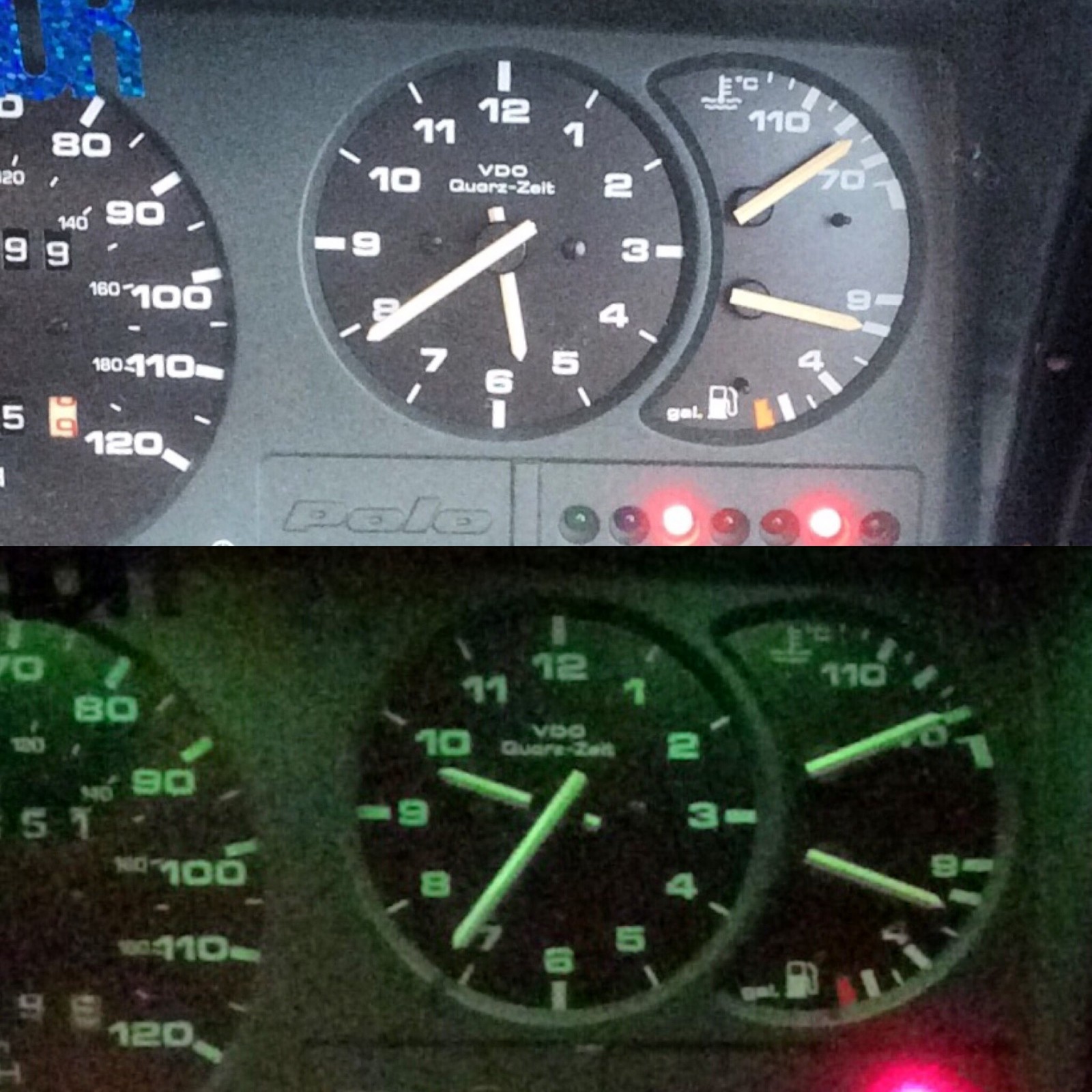

And now it seems to run too hot. Settles at just above 90 while driving and rises up to around 100 intermittently.

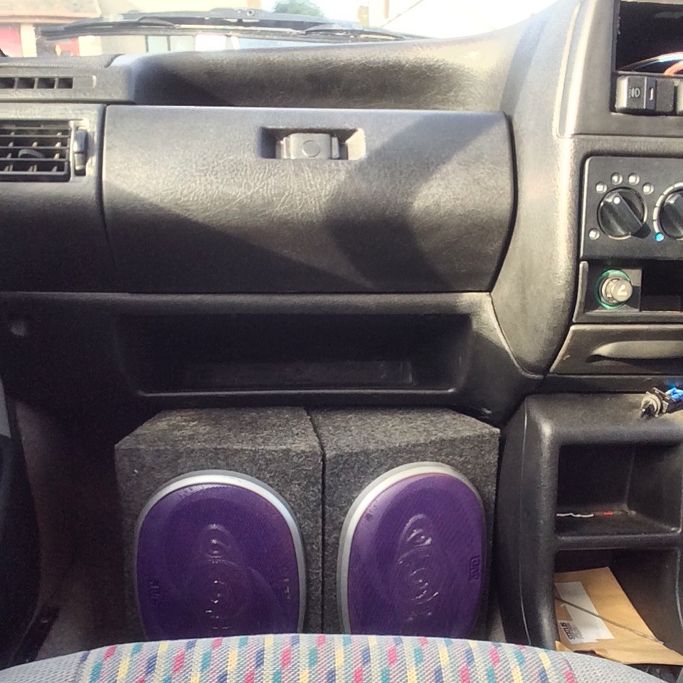

Also did a temporary speaker bodge so I don’t have to relocate to Stoke in total silence next week!
So I moved up to Stoke-On-Trent on the 6th and the car was absolutely fine for the drive and had done quite a few miles in the week as well. Only real issue I’ve noticed is that it doesn’t like going into 1st gear sometimes, I suspect stretched clutch cable. And now the temp gauge problem has gone the entire opposite way and doesn’t ever move so I suspect a sensor fault there. ?
