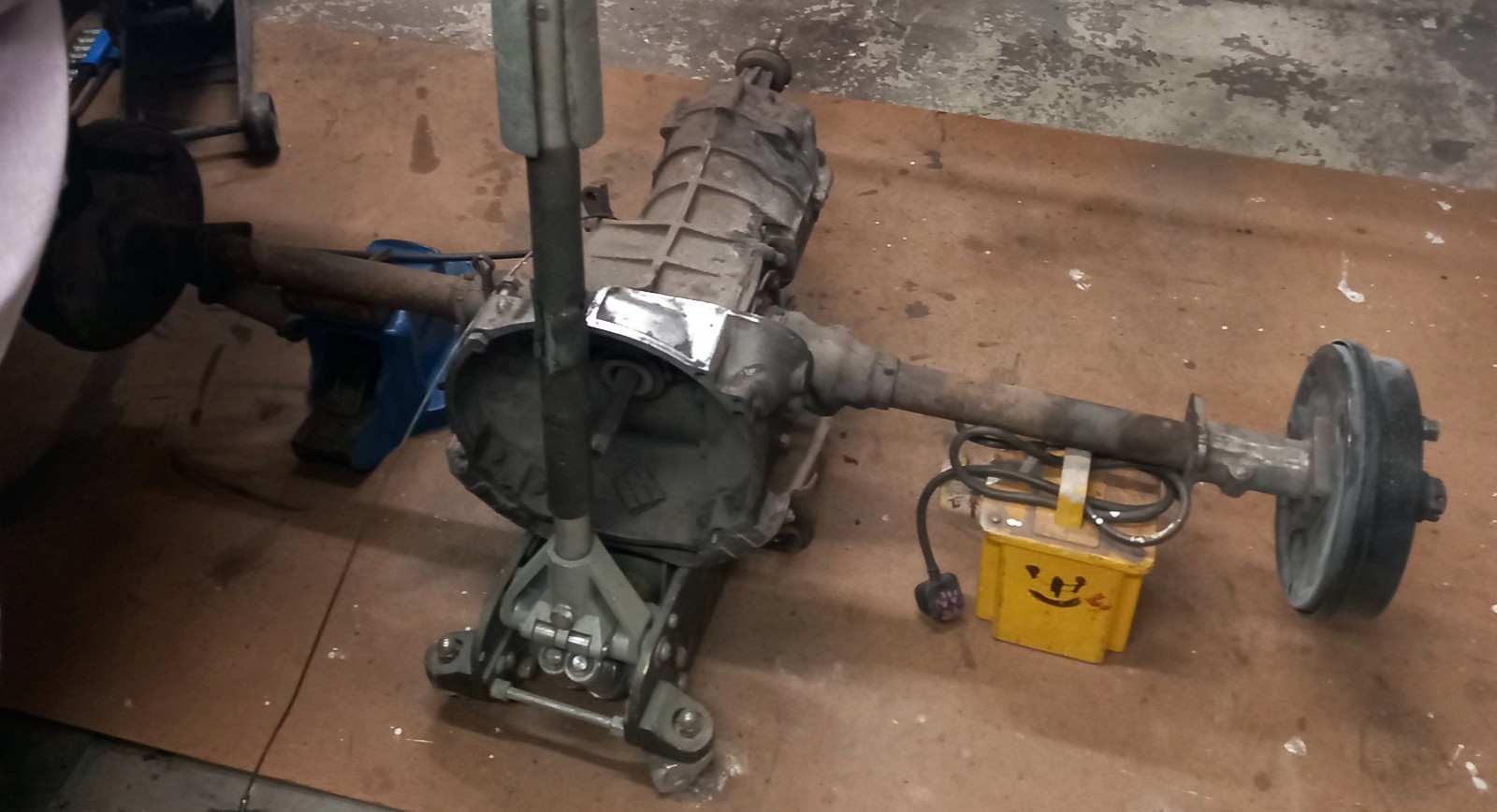

The gearbox next although it's much dirtier and with more crevices so not looking forward to starting that right now!

Bit the bullet and got the gearbox done. Gave it a wash with lots of 'Elbow Grease' degreaser, bit of wire brushing then some Hycote aerosols; etch primer, gloss black wheel paint and lacquer.
