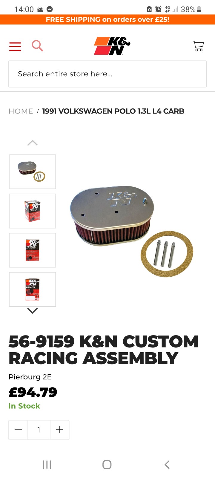

Hi guys, does anybody know if the k&n Air filter for the carb will fit on the injection models. It looks like the bottom of the filters are the same.

£95 !!!
Smash them an email and ask if they can measure the internal diameter of the outlet?

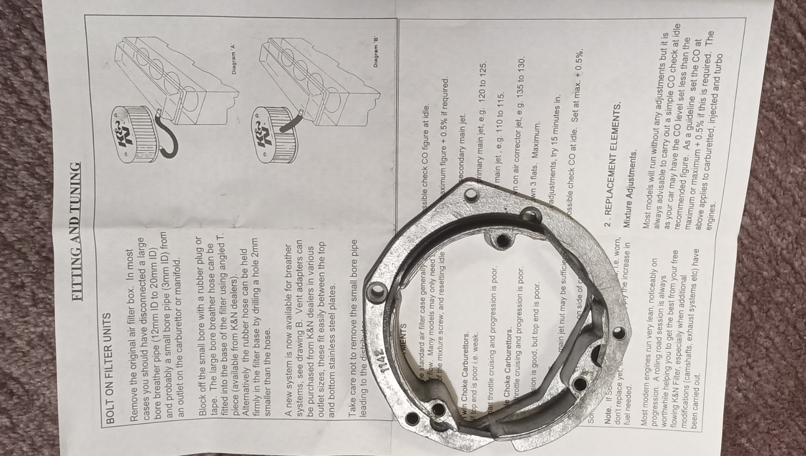

From memory the filter hole for a Pierburg 2E's circular top is 92mm...
and confirmed byIMG_20220203_212255_7.thumb.jpg.2c5fe3e1d8502f0a9145067c55340c24.jpg measuring a Weber twin choke to VW intake filter conversion plate.
Be careful about the three bolt holes though. They are not equally spaced so the filter might not point the way you expect to read K&N from front.
