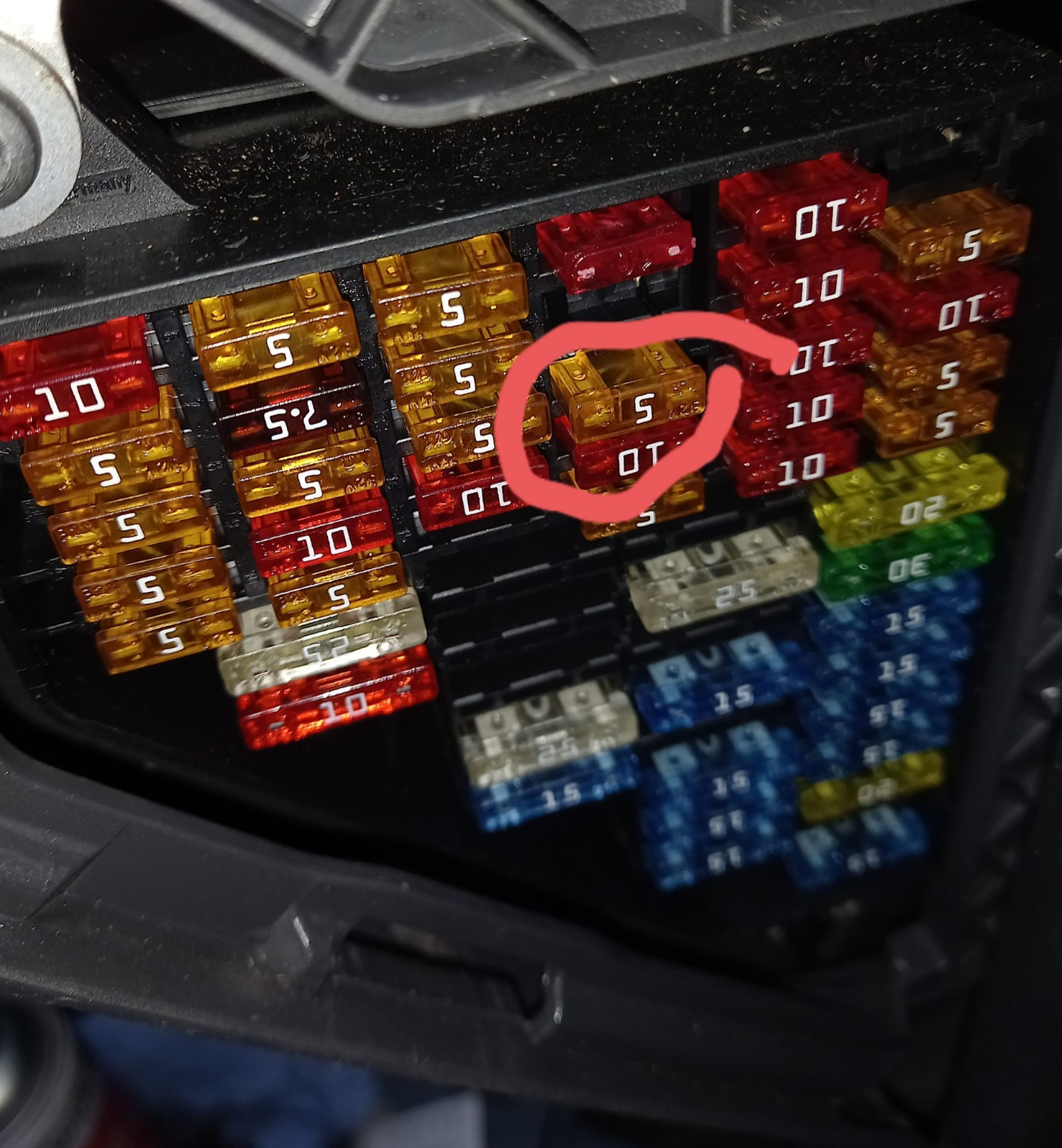

Have a check of fuse 18 before doing anything else, it's this one:

@Pete1 Thanks a lot for the info, Pete.  I just checked the fuse (and it looked fine), but I'll leave checking the other things to another time when it's less dark and cold out!  Appreciate the help.
